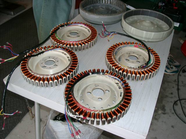

I've re-configured the windings on 4 stators of different wire sizes.- I'm interested in the 6 pole at this point of time as wind here is very slight. But one I configured to 7-2 pole in the .8 mm wire . It seems to be way down on volts compared to the 6 pole configurations.

My 7p2p conversion on 0.8mm wire is charging a 12v battery at a lower RPM than the old SP configures 0.6mm stator it replaced. Even though the 0.6mm stator has more turns per pole, the new 7p2p stator has a higher output voltage per rpm because the stator is not decoged, and 7 phase power has a higher output voltage than 3 phase.
Its working a treat, seams like its always going now where before it spent most of the day doing nothing. In fact I ordered a new 48 pole hub yesterday for the Lenz windmill, should be here middle of next week.
Have you tried one on your windmill yet. With your belt drive it will start a lot easier! You could even try that 3:1 ratio again.
