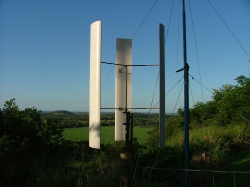

This is a picture of a small VAWT I made using the GEO222 extruded blades. It was only small, about 600mm diameter I think, so wont make much power, but it did self start and ran pretty fast.
GlennEdited by Gizmo 2011-04-22

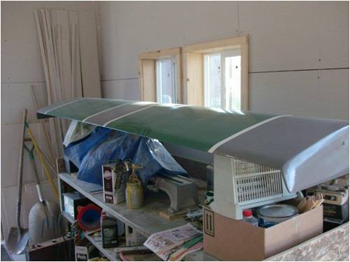

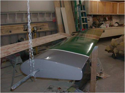

The wings are made out of spruce for the spar's and 3/16th" hard wood ply wood, waterproof glue was used everywhere, and the entire wing was fiberglassed after final shapeing and sanding. I then used automotive epoxie primer and then the colors were sprayed on. It's been approx. 2 weeks of work to make each of the 3 wings,(thats approx. 80 spare time hours each). The good news is that I'm getting faster with each one, and I'm on my last wing. Spring has arrived now and so the mounths of winter work in the shop are nearly over.
In the photos you can see (as Glen stated), rather larger than typical...The wings measure 9feet 4inches L x two feet W and weigh less than 40 pounds each. I've tested them up to 200 pounds center loaded, laying upside down, supported by saw hourses at the outer ends and only 1/4 inch deflection with no apparent difficultity or damage. (all measurements are in USA stds.)
First pic. is my very first full size wing, you can see the dust on it from all the sanding ect. I do have a air handler but it still goes everywhere.

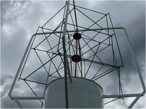

The second pic. is of wing #2 just after the last color, Wing #3 is in the background to the left in the photo. The final pic. shows where the wings will be mounted, You can't get a good eye on it-looks like pipes goeing everywich way, but there are 6 mounting stations, 3 for wings, 3 for counter weights or test stations for different air foils. The 4 white arms going up and over are 2x4" steel tubeing and will more than likely need futher refinement and braceing. The entire stack measures 24 feet from the ground level to the top of the frame.

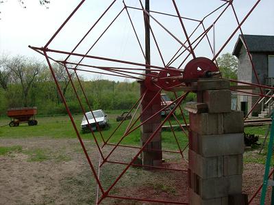

This may give you a better look at the rotating assembly. It's just under 12 feet in dia. x 9 feet.and yes- made on the farm.

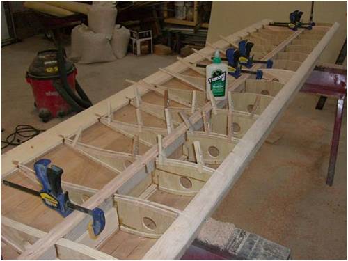

This gives you a look inside the wing during construction. Notice the grain is vertical on the ribs, very important for strength. Maintaining a tight fit through out and also keep the wing clamped during construction to prevent warping, all important. You may notice the little strips I'm glueing on the ribs, this is for attaching the 3/16"skin, approx. 1/2 off the 3/16" sits above the rib profile and will be sanded away.(the skin glues on between the ribs).
