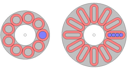

The advantage of cheaper magnets is you can buy more of them. More magnets around a stator means more coils, and more coils means a higher AC frequency. The faster the magnets pass the coil the higher the output power, and more magnets/coils accomplishes this. More magnets/coils does mean a bigger diameter alternator though.
You could use narrower longer magnet combinations, say instead of a single 50mm diameter magnet, 4 25mm magnets in a row give a 100mm * 25mm magnet, so you use a narrower rectangle shaped coil, making it easier to fit more around the circumference, and the long rectangle shaped coil also means more copper under the magnet.

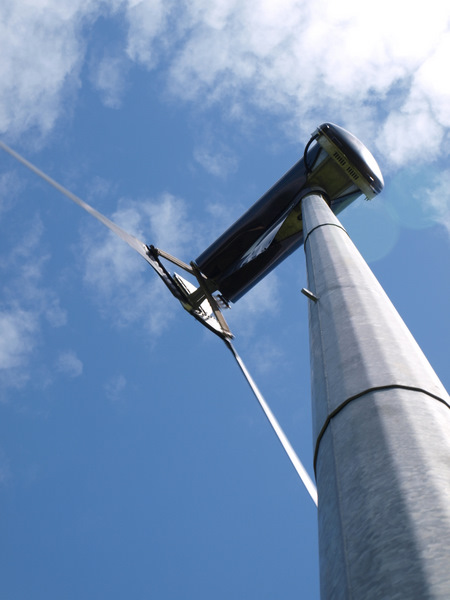

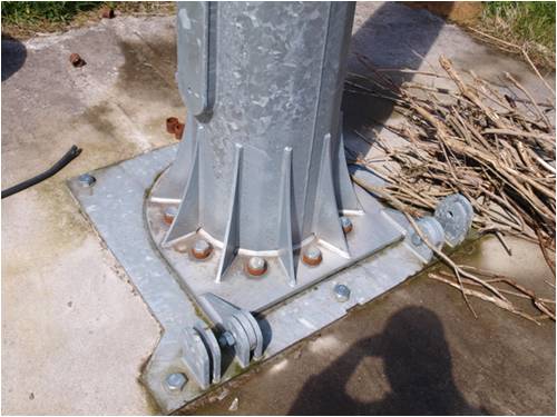

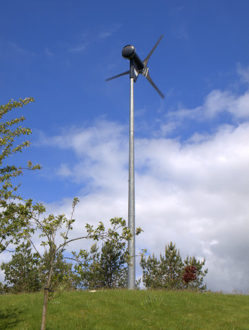

Anthony heres some pics of that proven machine ...nobody who knew specs about the machine
was at home at the time ..friendly people though ...
it (seems) to be the 5k machine , but it,s the first proven i,ve seen up close
so not sure about this
one thing very noticeable was how smooth the alt was at cut in...you could feel hardly any vibration in the pole , yet the alt was humming away
not much "helicoptering" from mast shadow either ...just sounded like a regular
upwind machine
i want one .....
pole does flex a little...shes a big girl

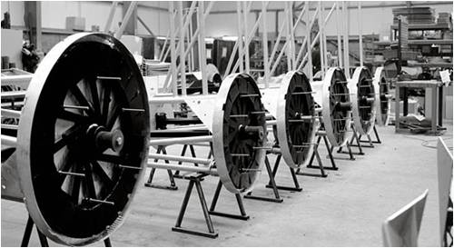

found this pic on the proven site....seems to show different combinations of
ferrite numbers on different alts
