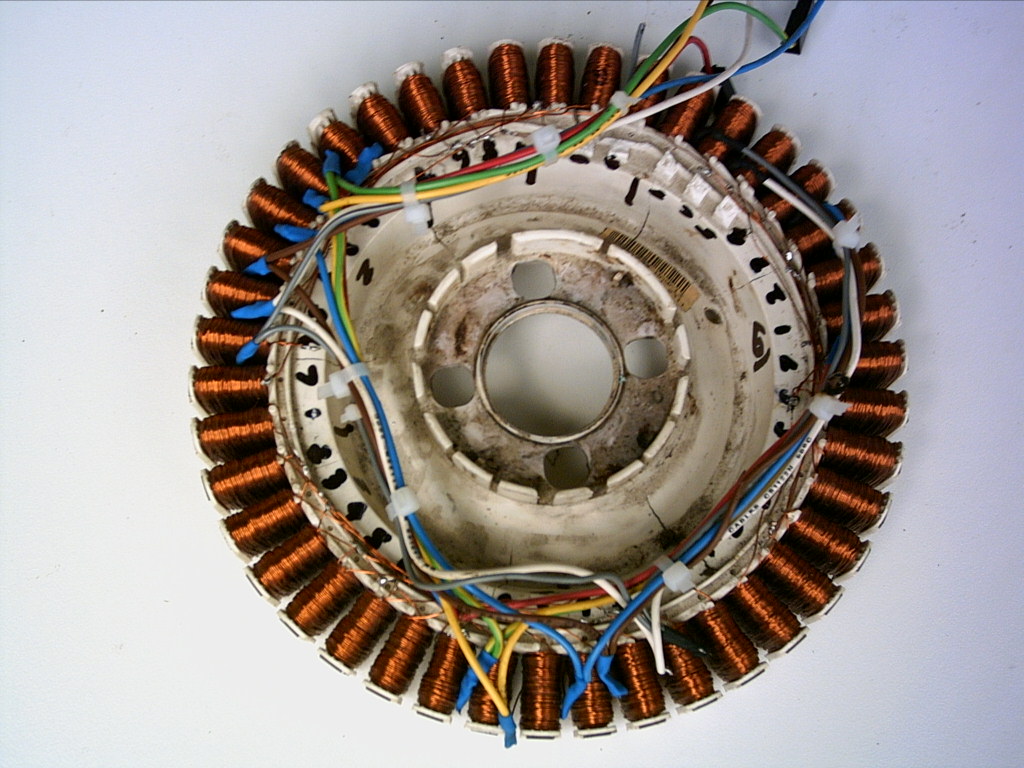

Hi well done Glenn & Bruce on the discovery of the cogless stator. Using the excellent article I have put together a .6mm 7p2p stator, awaiting the new hub to complete.Looking forward to the open day here in Mackay.

Posted: 10:09am 05 Nov 2006
Looks good Andrew.
I started on converting a 60 series to 7 phase this weekend also. Unfortunately I had decoged the stator about 2 years ago, now not needed with a 7 phase conversion, but its the only 60 series stator I have so it will do.
