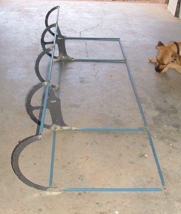

Hey I'm going to buy the sheets of aluminum for my lenz2 wings this weekend. The sheets, 2400 * 1200, will be pop riveted to this frame....
Now I have a choice of 1mm ( $50 per sheet ), 0.8mm ($40), or 0.6mm ($30). The 0.6mm is cheap, and I'll need 3 sheets, one for each wing. But I wonder what it will be like to bend around the nose, will it be too weak, etc. I really dont know as I've never used al sheet before.

            Eh mate 0.6 might be a bit too flimsy 0.8 I reckon would be better but also to help stop the al buckling between the bracing I'd be tempted to make some angle out of the off cuts and add a heap more bracing. Now looking at the picture it looks like your nose spacing is 600mm. Now what I'd do is install some angle around the radius to help strenghten the nose, put another cross brace at the centre nose prop then just put some angle across each setion in an X arrangement. By using al angle it shouldn't add too much weight but the extra anchor points will give the sheet better adhersion and shouldn't tend to buckle. The last thing you want is a bird flying ito it and leaving a nice nose impression in your new blades.

I sorta hope this does not sound to old fashioned to you, But the more I look at that frame the more I think of the model planes I used to build as a kid.
It seems to me that a fabrick cover at least on the large flat area might be light and strong.
Also the leading edge could be done with 1/2x1/2 spars running the length of the leading edge and let into the curved shape so they ended up 1/32 inch proud of the outside of the curved ribs.
This could then have a thin layer of pvc of formica type material laminated to it with contact glue.

I expect the thin alloy would be strong enough and easier to wrap around the frame.
If your sheets are big enough I suggest bending a stiffening rib (say 20mm at 90 degrees) along the end that will be fitted to the edge at the top of your frame as it is lying on the floor. Once you start wrapping the sheet around the frame that is the place where I think the sheets will try to buckle.

I then did a search on Fieldlines for Ed's big Lenz. I dont know how he went with this, but he used 0.020inch aluminum sheet. Thats about 0.5mm. The story is Here. So I might buy 1 sheet of 0.6mm aluminum and see how it handles when I roll and pop rivit it onto the wing frame.

The .020 works well.   I attatched the outer nose section first and simply rolled the frame around the sheet.   Works great!    Looking forward to seeing your new machine!
