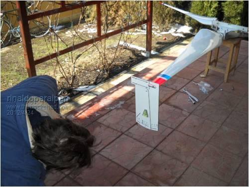

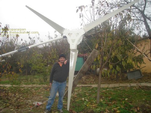

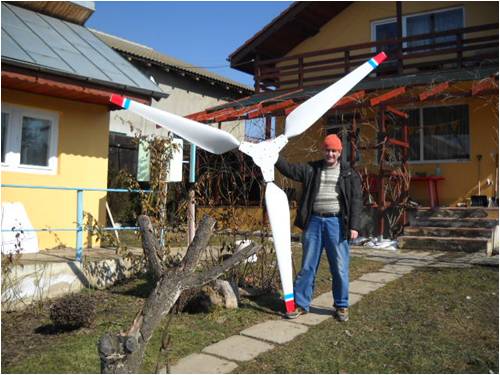

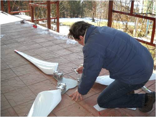

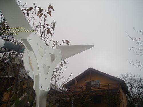

Hello,
I already finished my new turbine(the third, after two sets of wood blades);It has an incredible efficiency.
The blades are 3,10 m diameter and they are made from epoxy resin and glass fiber coated on a STYRODUR core.
The generator is made with 12+12 30x30x20 N42 magnets and the coil has 75 turns 3x0,85 mm cooper wire diameter
Estimated power about 1,8 kW
http://www.youtube.com/watch?v=q2PL5NikIgI&feature=BF&list=U LvJ1Y8kJ_b_g&index=4Edited by Gizmo 2011-03-24

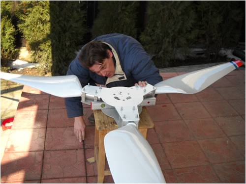

Very nice work on the blades and mounting with the clamp blocks . It looks like you have done an extreemly profesional job and engineered the blade hub and mounts to with stand the forces exerted on blades .
I also went with a similar clamp on my blades that I tested to 6 tonne .
What is the airfoil spec ?
Why have you been through 2 sets of wood blades and then decided to go to what I would think would have been a lot of thought, design and work to create this blade and hub set?
I would think 1.8Kw would be conservitave max power.
Well Done The Rewards for your work and patience will come !!!Edited by fillm 2011-03-19

rinaldoparaipan
Welcome to the 4m. Your blades are other-worldly; very sleek and they look well made.
I was curious if these blades fit the profile shown by Alton's Calculator. I entered 3.1 m blades in the calculator and came up with the following data:
11 24.6 488.4 49.8 475 1847 0.94
"1847" is watts (1.8 kw) and "11" is wind speed in meters per second with "24.6" being wind speed in miles per hour.
Is this how you came up with your estimated output?
I'm wondering if your blade design might actually be more efficient than what is described here as "optimum" on Alton's Calculator or if what Alton's calculates is really as good as it gets.
Either way, great job and thanks for sharing. Please let us know your "actual" output results when you fly it.

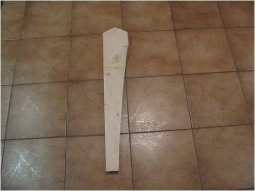

rinaldoparaipan
Joined: 18/03/2011
Location: Romania
Posts: 21
Posted: 08:48pm 18 Mar 2011
Thank you all for appreciating my work.
Unfortunately, my generator is not so powerful to push the blades up to the maximum power limits.
The generator was build for my first smaller wooden blades, and “updated” by doubling the magnets.
I’m planning to build a new one, in order to” suck” as much power as possible.

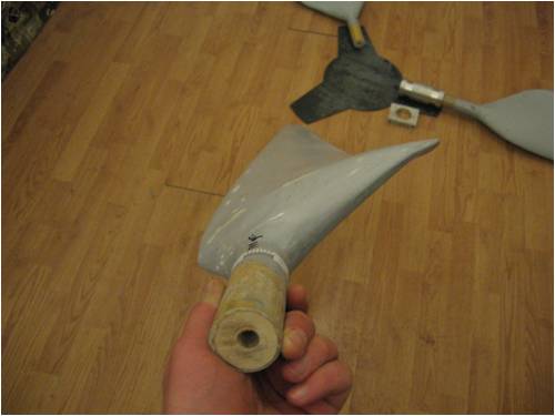

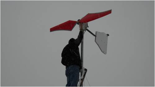

This is the blades history.
The red one was the result of the cutting test program.

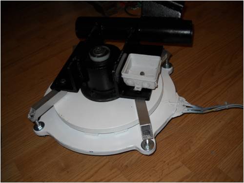

rinaldoparaipan
Joined: 18/03/2011
Location: Romania
Posts: 21
Posted: 06:01pm 19 Mar 2011

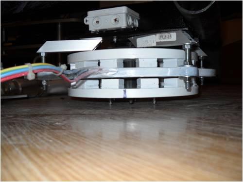

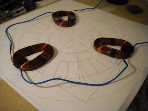

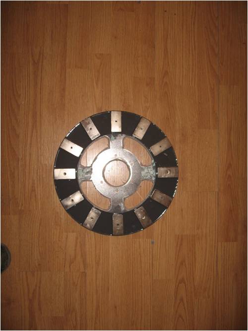

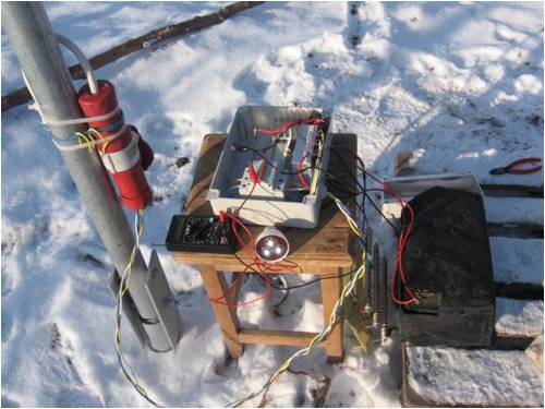

MY FIRST GENERATOR
PRIMARY TESTS
Bryan1
Joined: 22/02/2006
Posts: 2298
Posted: 06:02am 20 Mar 2011

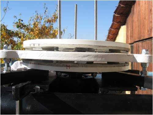

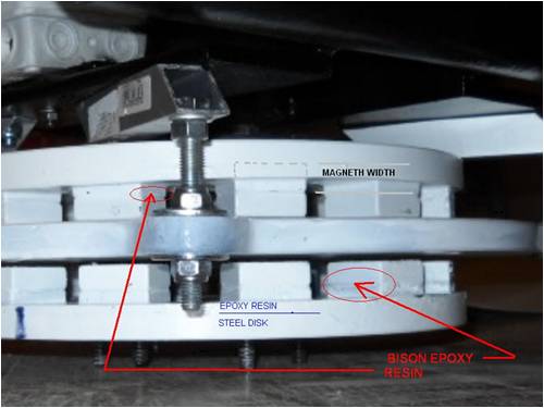

Hi rinaldoparaipan,
In that last pic I noticed you have double stacked the magnets, now from what I can see there isn't anything there to stop them flying off in a high wind.
My suggestion is put a stainless steel band around the outer diameter of each magnet rotor and epoxy the magnets in. This will help the magnets as moisture will soon get under the paint and the corrosion on the magnets will start before you know it. In the wind game superglue has been re-name stupid glue when people rely only on the stupid glue to hold magnets in place. I have seen many failed pic's of magnets flying off and after the great work you have done I personally would hate to see a pic of the disaster when it happens.
Regards Bryan
rinaldoparaipan
Joined: 18/03/2011
Location: Romania
Posts: 21
Posted: 08:13am 20 Mar 2011
Hy Bryan,
Thank you for your suggestions.
The new magnets(second row) are glued on the old magnets with Bison Epoxy Metal that has a 160kgf/sqcm bond strength.
http://www.bison.net/US/en/view.do?UID=af993e0fc2c7dd2dc07c0 4
http://www.bison.net/upload/af993e0fc2c7dd2dc07c06.pdf
The first row of magnets are “buried” about 5mm in epoxy.
As seen here
http://www.windgenkits.com/video4.htm
the magnets are only glued on the disk
So, for the second row of magnets I adapted that solution. I hope will be no problems.
Regarding the anticorrosion protection, the magnets are nickel-coated. I’ve made some tests with a similar magnet , outside in the rain, and after a month of very bad weather and frost there was no rust spots on it.
Anyway, the height of the tower allows supervision and maintenance works.
Any recommendations or observations from old experienced persons in windmills construction, is welcome.
You have a modified picture with details
I hope everybody understand my ideas, I am NOT a native English speaker.

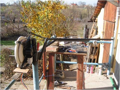

KarlJ
Joined: 19/05/2008
Posts: 1178

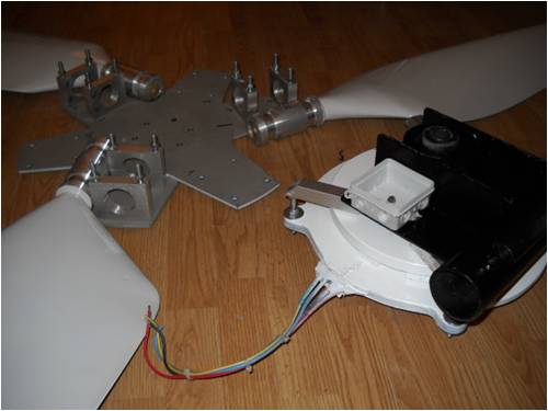

Posted: 11:44am 20 Mar 2011
hmmm
me thinks burnt stator is next

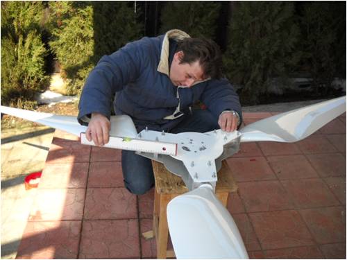

but yep nice work on the blades

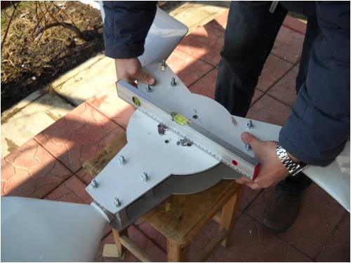

whats the thickness of the plate they are mounted to?
AMACK can tell you if it isnt thick enough it will bend and the blades
smash into the tower, a shame for such a nice set.
Top work so far, the real test as we all know is time, keep the pics coming.
KarlJ
Posted: 03:01pm 20 Mar 2011
I would agree with Karl, the blade hub plate looks too thin. Perhaps a similar plate could be bolted on top to the studs sticking out of the blade shaft clamps?
It would be a shame if the blades hit the mast
rinaldoparaipan
Joined: 18/03/2011
Location: Romania
Posts: 21
Posted: 07:57am 21 Mar 2011
Sorry for the confusion.I did not upload the correct pictures.
That is the final shape of the hub plate.
It is a spatial structure, so no problems with bending stress.
Steel plate thickness is 7mm.

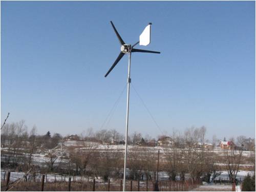

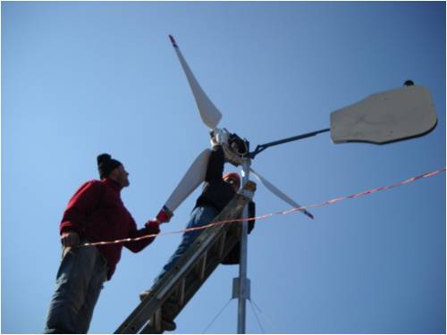

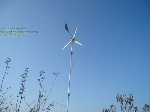

Posted: 06:52pm 22 Mar 2011

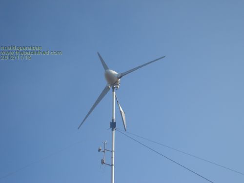

This is how my turbine is working.
Start-up at 0.6m/s wind speed and charging at 2m/s.
http://www.youtube.com/watch?v=AJKzdaeX8lgEdited by Gizmo 2011-03-24

Posted: 09:47pm 22 Mar 2011
Dad loves your scaffolding to work on it
Posted: 10:48pm 22 Mar 2011
Hi Dan
I edited some of the YoutTube links for you. You can make a link clickable with the button.
Nice wind turbine, and those blades perform very well. Well done.

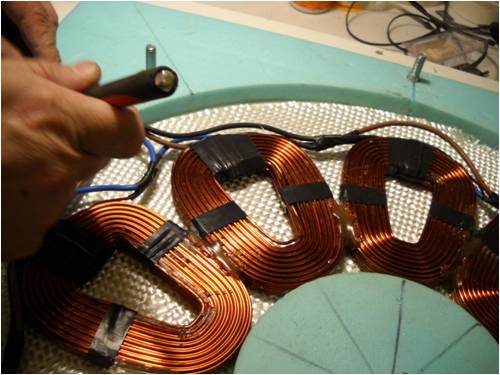

rinaldoparaipan
Joined: 18/03/2011
Location: Romania
Posts: 21

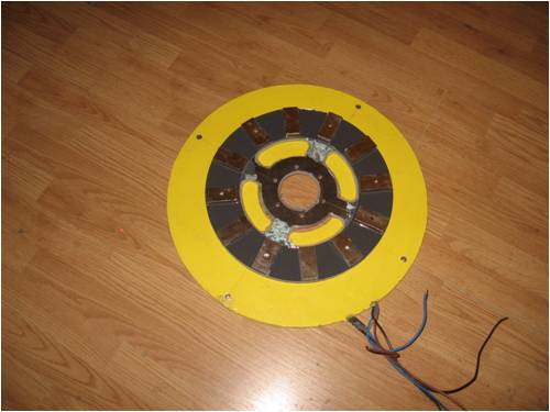

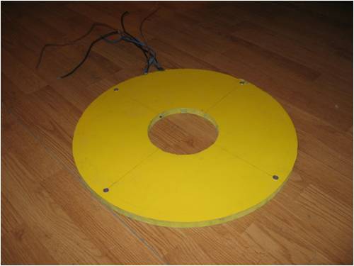

Posted: 06:57pm 15 Apr 2011

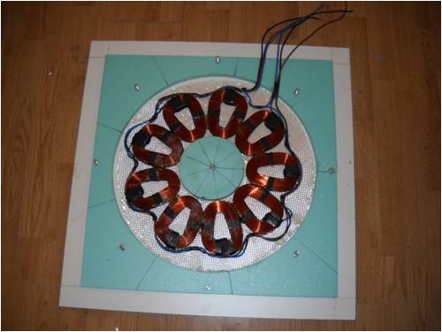

Hello all,
This is my new generator for the blades.
60x30x15 magnets and the coils 88 turns 2mm wire diameter.
Tomorrow I'll start to mount it.
Let's see what it can do!!
