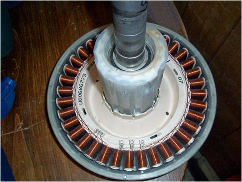

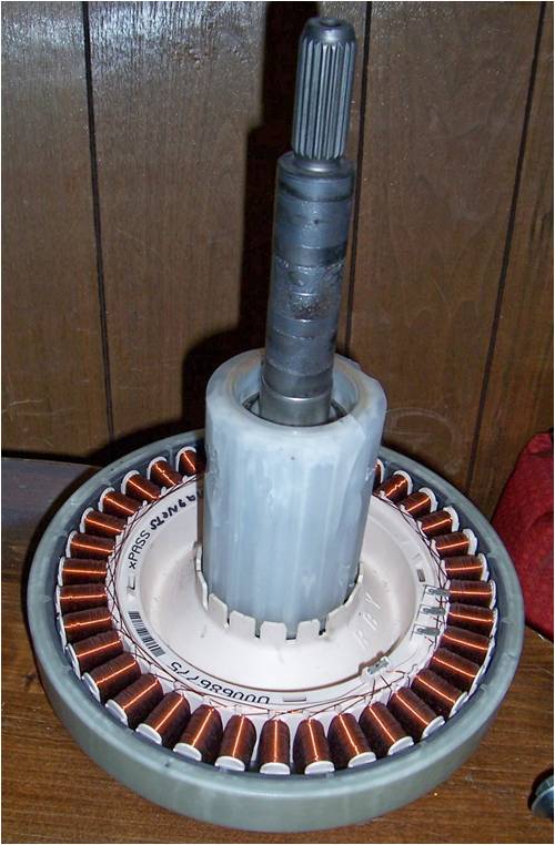

stator I purchased from the states.
It has 36 poles with a count of 16 magnets.
I mic. the coil wire its .023".
Can Anyone I.D. what motor this might be.
what would best suit output configuration.
I'll try and upload picture.

Hi Chuck,
I'll stick my neck out and say it's a third generation 60s F&P unit,reference info w.w.w.ecoinnovation.co.nz under the category of Manuals.The reason for this claim is the F&P 60s wire diam. is aprox .6mm/.024" close enough!
cheers Rastus

Hi Chuck,
I think it's a second generation 60ss F&P,taking into account your round pole note!The round poles improve the motor by reducing "cogging" so the rotor runs feely.For generators this is a significant feature.The blades should turn in the least amount of breeze.I havn't seen 1,only read about them.As far as wiring options for 12v,I'd consider matching it to your 5 blade rpm range.I'm also hoping this post will increase traffic and assistance for you! cheers Rastus

Hi Chuck,
I've noticed the terms I've used are confusing ,so to clear things up, the 60s(series) are the F&P third generation motors.The round poles are classed as a 60ss F&P because of improvements.Becoming a 60ss(series second) stator.The coil wire size for both is the same.Matt's advise on wiring selection comes from practicl exsperience!You won't better that.Cheers Rastus
