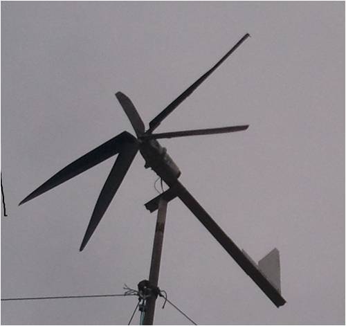

Hi im back and still in need of your help got my first mill built and it works BUT it keeps smashing the blades.
I have tried 3 different blade types (all home made ) a 6 blade a 5 blade with different lengths of blade.
All have come to a sad end 1 was due to no lode i think it went to fast.

Yeah I agree with Shawn, you cant go past timber. They are cheap and strong, and they dont have to be perfect to work well. You can buy extruded or cast blades, they work well but cost much more that a timber plank. If you have the time, timber is the way to go
I did play around with PVC blades cut from pipe like yours. They work pretty good in low winds, but will bend back and hit the tower in strong winds.

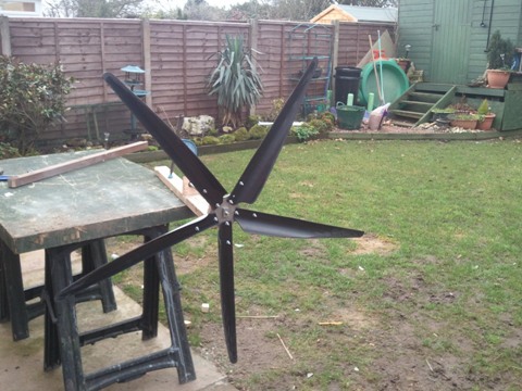

Hi i have see two plans on wooden blades the chainsaw one and one from utube
Has anyone got some dimensions or how to plan for the blades size i need i can do a 4 blade.
useing about a 600 blade then hub 600 blade is this the best size ????
What angel see one for 22 d is this the best all comments would be much appreciated
Thanks for your tome so far

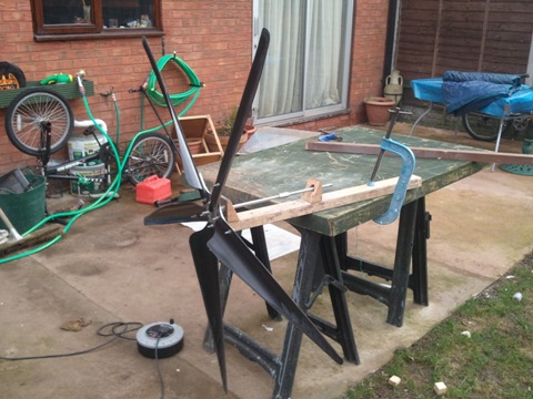

This is a pic of the ones i put up today don’t know how long they will last
Spent some time balancing them
Reddbull alan

spending extra time balancing Alan is a good thing ...it,ll let them run smoother with less stress , i,m not so sure about a 4 blade prop , they seem to suffer (like a 2 blader) from vibration when the mill yaws and will try to shake things a bit...though saying that a 2 blade seems very close in efficiency to a 3 blade
its a decent size good looking prop...maybe having a tail that furls a bit would help with the blade smashing problem ?...
you could knock up a simple constant pitch 3 blade prop using hand tools and wood ,a rough airfoil shape with a bit of taper should be fine ...trick is matching the prop to the load the generator presents ...no easy answer there , experimenting a bit might be the only way ...i couldn't find any examples of the kettler threadmill motor used as a mill , if it was an ametek youd have plenty of reference material ... but theres not as much fun in that .... Edited by niall1 2011-02-11
