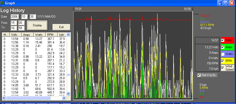

First data :) , cheers Glenn, this is gonna make testing blades so much easier. Needs calibration still a but for a relative comparison is great already.
this is an odd combo i have up at the moment, starts in light wind but yet to see if it gets the rpm.
http://eds.dyndns.org:81/~rifraf/windmill/blades5.jpg
Posted: 08:13am 30 Oct 2006
Nice looking blades.
On my PicLog the wind speed isn't calibrated, wasnt real keen on setting the whole deal up in my car with a laptop and driving up and down the road. But like you say for comparison it doesn't mater.
Did you know if you click on the graph and drag your mouse it will select that part of the time line. Its a bit buggy so I never published the fact.
