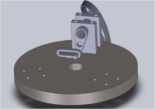

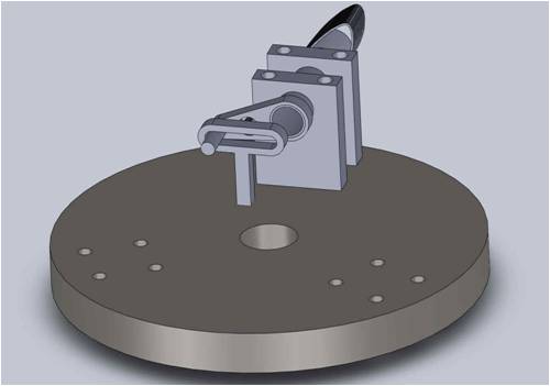

Variable Angle of attack or pitch control
First I would like to ask all,
Is it better to start a new post or is this location good enough.
What is best for these blades? Variable angle of attack system or fixed for a 3 meter per blad by 3 blades windmill. Since I want to make one that is 6 meters at least.
What do you all think?

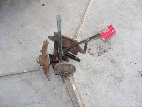

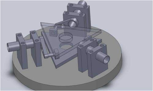

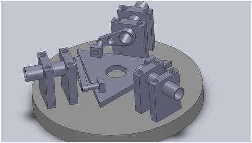

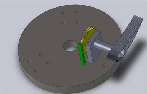

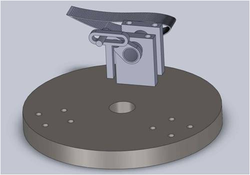

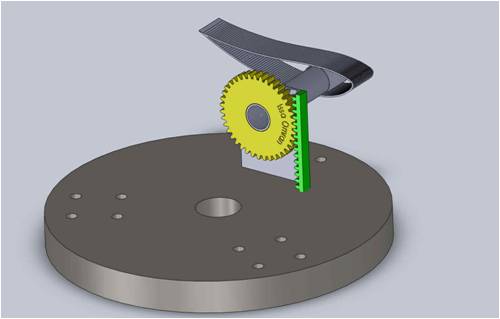

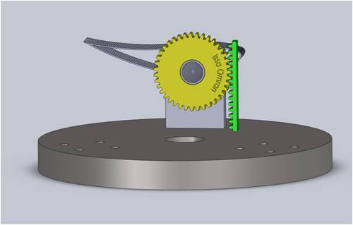

Here are some pics of different angle pitch control systems. What do you think?
I like the pinion and gear system but I need the calculations but also it needs something to back up the rack, I also like the? Scotch Yoke Leaver system simplest also has self limiting property.
I still need to do lots of math/engineering. Any help there?
Please all comment
want real scince

Hi udsn
The scotch yoke in your last picture is the simplest to do, but is better with a round pitch plate than a triangle as it is easier to combine into a governor system. However the engineering of a device such as this would require a machine shop and the skills to use it otherwise the cost would be to great.
For our size mills it is better to stick to something simple like a furling mill or even a high speed non furling mill, if you are thinking of a multi KW mill then the pitch control may be a proposition, but will be a high maintenance device.
KISS is the word.
All the best

Posted: 01:36pm 22 Feb 2011
Hi all
Thank you all
Thank you and hi both Rastus and VK4AYQ
The Scotch Yoke is the first three pics.
I am working (theoretical) on 5 Kwatt system 6 meter long diameter. I only have the
aluminum blades.
What do you mean high maintenance? Why?
I think the best to lower maintenance is the ball joint system.
Something that is engineered for outdoor use in the first place. for dust ,water, extreme conditions, also ready off the shelf.
Do I need a range larger than 90 degrees?
What is the optimal for GOE222 ??
Best regards

I have toyed with the idea of variable pitch angle partially to protect against overreving. My dreams are to make a sevenish meter diameter three bladed mill. Safety of the mill is a big concern to me. My thoughts were to make a govenor. Ideally I would find the front of an aeroplane but they are difficult to get hold of. I live a couple of km from the coast so everything needs to be salt and weatherproof. I figured hubs and stubs would be ideal for pivoting the blades. I have wrecked a few David Brown tractors over the years hence having these stubs to spare. Being taper rollers and only one oil seal I figure they will last forever in this job. Also with the wheel nuts it would be very easy to attach and remove the blades from the mill. On the inside of the wheel rims I thought of welding a short piece of 100mm pipe and fixing the blades at the end of that. Pretend that the long skinny bits of wood are the blades. The 20mm piece of pipe would be the shaft the windmill turns on. My thoughts were of using a car diff and facing the center part down with a length of 50mm pipe as driveshaft so that the generator would be close to ground level vertical. Again using a rim and wheel nuts to attach the blades to the diff. Possibly use the brake at the other end of the diff. The red box would be a counterweight so the govenor could be adjusted. On the opposite side of the rim to where the govenor is fixed I would make a set of linkages so that the three blades have to swivel together the same ammount.I struggle to explain myself well. Sorry.Does all this sound like a mad idea? Would welcome suggestions. Thanks very much Oscar

You seem to have a lot of ideas about your mill,but I'm struggling with the connections.Aeroplane blade pitch controls can have hydraulic actuators adding complex and exspensive gear to a home made mill.The axles you have will be usefull components in your build.Unfortunateley I can't follow the description about the governor and its levers so I'll have to leave that to others,

I do not blame you for not understanding. You have possibly seen the govenor on a pre WWII stationary engine where round balls fly round and by centrifugal force regulate motor speed. Well I thought of making three of these in the front of the mill, one for each blade. As the blades speed up it throws out the steel weight and causes the blade to feather more (or less am not sure which) by two linkages each. Is that still clear as mud ? In general I beleive in the kiss (keep it simple stupid) idea but figure this might be a good safety mechanism. It would be trial and error but by changing linkage lengh and weight amount should be possible to get it fairly good. At very high wind is it safer to tie a mill up or keep it spinning out of the wind? Cheers
