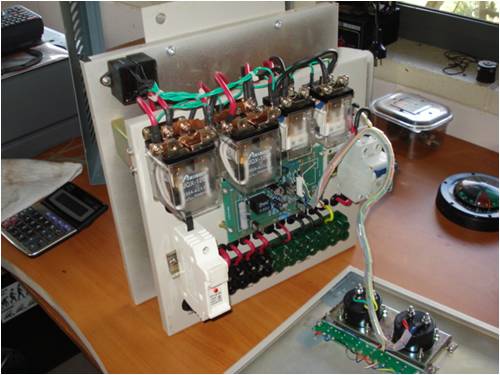

Gee, I have not powered my 2Kw unit up yet ,, I'll tell you what I think ,, First, the complete unit including tower and all fittings arrived nicely , although a bit shaken ,no Problems.
The controller , I opened it and found some surface rust around the hinges for the door, so scraped off this surface rust and epoxy painted the little areas,OK.

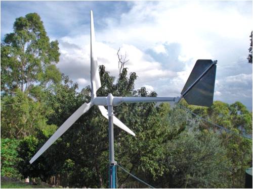

The tail and fin, a bit of surface rust appearing ,,so did a re-paint with epoxy paint ,OK now.
Last few days have been installing the controller and dump load (, which had a bolt and nut floating around inside ),no Big problem.
I'm sorry to hear of your Problem with them .. In general , mine appears to be a nicely made and designed product , just the cosmetics need a bit more attention ,imho.

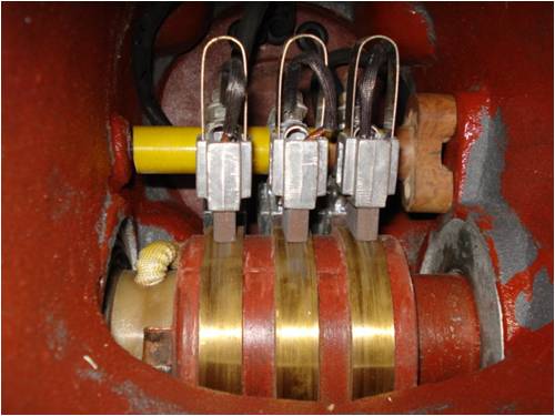

I'd like them to e-mail me some drawings , so I can safetly dismantle the main gennie for re-greasing the bearings Etc.I've inspected the slip-rings and they seem to be very sturdy. I did seal the tail to the main body with silicon to act as a seal.
I have the twin of yours, Bruce. No signs of any rust yet on the tail. My controller is different to yours because I got mine made to handle 2KW PV. No signs of rust there either.
[/quote]
I got some drawings from them, Bruce - I thought I'd sent them to you? They're not real flash, but they should help.
