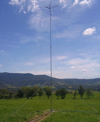

Here is a pic of a 15m tower windmill [whisper200 1kW, 8'rotor], I have measured.

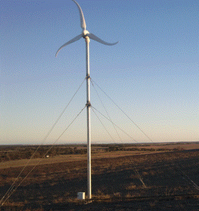

Here is a pic of a 10m tower windmill [Skystread 3.7, 2.5kW, 3.7m rotor], I have measured.

My estimates put your blades at about 5m long. You may choose to confirm the dimensions. Good luck throwing a rope over a windmill up 15m to try and stop it.
