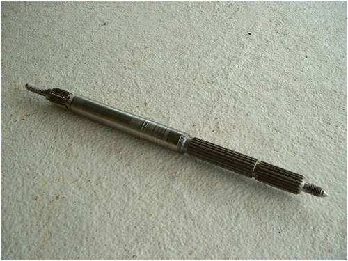

I cut extra spline on F&P shafts. I use a face cutter on the mill and so the included angle of the cut out is 90 degrees. I don't know what it is supposed to be, but 90 works good. I have cut heaps of them.

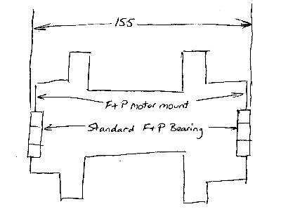

No, the standard F&P block is too short. My cast block spreads the bearings apart further than the F&P block. Bearing to bearing length on my cast block is 155mm.
The F&P block could be joined though inside a piece of steel pipe to make up the length.

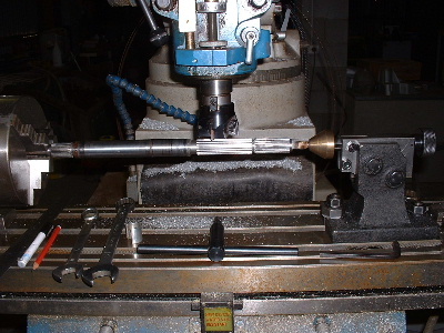

I found a picture of cutting the spline on the mill. May be of some help to someone trying to do their own. And some other pictures I probably have posted somewhere before.
Trev @ drivebynature.com

Nice Work,
Do you cast the spline in the prop hub or machine it in after casting?
I casted the spline into a couple of hubs i made, that worked quite well, and the trick is to blacken the shaft with lots of soot from a acetylene flame on the oxy, before casting as it gives a micro clearance after to press the shaft out.
Pete

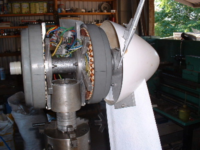

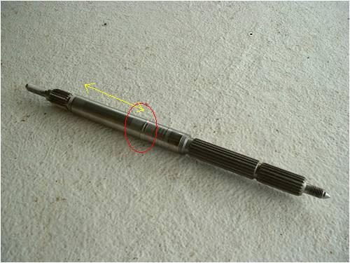

  Trev said   No, the standard F&P block is too short. My cast block spreads the bearings apart further than the F&P block. Bearing to bearing length on my cast block is 155mm.
Hi Trev,
This is a picture of your finished extended shaft, I think. I have not wanted to pull my white pointer apart to take a closer look but...
Do you leave the slight raised part on the shaft in the centre when machining? (the bearing stop for want of a better name) Indicated in red circle.
If you do, couldn't the original bearing block be used on the shaft the way it was before while in the washing machine? (Indicated but the yellow arrow)
If the answer is yes then are you able to extend the spline further up the shaft and not put the extra thread on. Say extend to within 20mm of the bearing stop?
This way a stator could be used on both sides of the original bearing block and then there is heaps of spline left for extra stators and magnet hubs to be put on if the customer has the aptitude to fix the stators in place along the spline.
I only ask this because this is what I was planing to do with one of your extended shafts with my next mill project and now the subject has come up it seems the perfect time to ask.
Yes
Yes, I see no reason to take it off.
If the answer is yes couldn't the original bearing block be used on the shaft the way it was before while in the washing machine?
Yeh you are right, the original bearing block could be used with the spline machined up further. Mounting the front motor, the magnet hub would need a spacer to set it in the right position from the raised bearing stop. Then you would need a spacer up to the blade hub mount.
More machining, more expense. May as well put that expense in a decent bearing/mounting block.

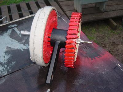

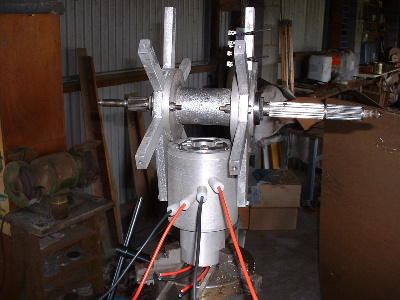

Hi rastus here is a picture of my mill (early stages ) i took the original aloy bering housing with plastic around it then removed berings and put it in my house fire with a small fire on so not to melt alloy this removed all the plastic then put inside pipe and used sealer sikaflex would do great but cost to much for me so i used cheap wood bonder
and presto
easy as pie and this has now seen alot of wind getting 120k gusts as i write this.

This is a simple cheap exercise that gets rid of the plastic easily, but what holds the alloy bearing hub inside the steel pipe? Did you say "used cheap wood bonder"? to bond steel to alloy?
Have you noticed any magnetic flux / loss of power issues with 2 motors so close? I have never experimented with such, but would be interested to know.

shawn
Joined: 30/03/2010
Posts: 210
Posted: 06:10am 29 Dec 2010
LOL year i used (no more nails) big mistake its a water baste product i would not recomend for this job and it is showing signs of movment one day when i have it down i will strip and biff back in fire then put fiberglass or solvent curing sealer in the gap the stators bolt onto the original alloy housing each side so it canot go anywere my only worry was the whole thing spining inside the pipe so before i sealed it i pointed my welder inside the pipe and run afew messy spots of weld in there
have had great power output have not the knowhow to test flux

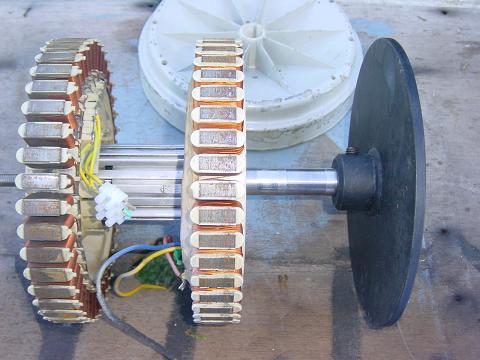

Pic's are great! They help remove some of the guess work. Does
the second rotor have the spline bored out, and if so was it done on a lathe?
If it is original have you used "links & parts" related to this site, hope you don't mind me asking! From the wind conditions you must have the furling worked out just right.
As a brief comment epoxy ressins can provide strong bonds if temperatures don't become exstreem.The spot welds surely would have done the trick.
cheers Rastus
shawn
Joined: 30/03/2010
Posts: 210
Posted: 08:25am 29 Dec 2010
Yes the spline was drilled out and you can just make out the keyway in the top picture this weakened the plastic magnet hub and they arent that strong to start with but cost peanuts and i have heaps, none have broken yet !! but if you have the gear to extended the original spline or bought one it could be stronger.
and the arm coming out can be adjusted so the offset from the mast is adjustable so once tail is made and angles are welded you can play with furling untill happy.
(I AM THE KING OF COPYING GOOD IDEARS) that others slaved over for hours and hours.
O buy the way i forgot the original alloy housing has a little you have to take off it held a seal that is not needed. After burning plastic off its easy to see were to cut i used a hand held 9 inch grinder with a cuting weel on easy as pie.
remember the stators are snug up to the berings so they line up perfectly Edited by shawn 2010-12-30

Posted: 11:53am 30 Dec 2010
Hi again,
I have done the same as Shawn with the melting of the plastic but instead of putting it in round pipe I have put it in 65mm square pipe. You have to use a file and file the centre of each side in the middle so it looks square. Not too much but just right.
Then you use a bearing press to force the hub in to the square tube.
No glue or anything to hold it just a bl**dy tight fit.
Shawn where did you get that metal disc with the grub screw in it from?
I wish I could get such a thing with the splines in it but that one you have I might be able to adapt to do the job I need.
Trev this is why I asked earlier if the spline could be extended to the bearing stop.
