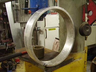

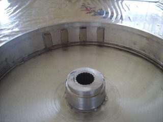

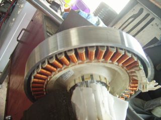

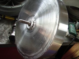

Just last night l just finish Fabrication the First F&P Alloy Hubs and is alot work and got three more to go and hoping will finisih in next few more days .
l going place some photos sometime tomorrow for everyone to have alook and let me know what you think ? or

Very nice work D . wonder,are you going to insert a steel band on the inside of the rim??
Helps when placing the mags-they stick nicely .

hi Bruce
l have roll of piece of the flat steel band is 1.2mm x40mm on the outside of hubs so magent stay on while l taking some photo and at the momest l am trying to work how many magent will go on and there are 2 off 3mmx12mmx20mm and might have to order 6mm thick instead 2 x3mm .
