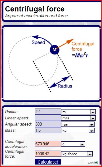

Out of curiosity i went looking for a calculator for centrifugal force and found this handy one.
http://www.calctool.org/CALC/phys/newtonian/centrifugal
I was interested in the force a set of blades applied to the mounting point of a windmill under centrifugal force at peek RPM.
A set of 2.4m blades, with a weight of 1.5kg each, spun at 500rpm will exert a force of 1 ton to the blade mounting point of a windmill.
No wonder things fail at times

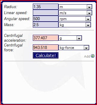

Posted: 05:39pm 12 Dec 2010
Hey Pete,
You need to apply the mass of the blade at the blades CG. You should have entered 1.2 (roughly where it may be) not 2.4m
Still a lot though.

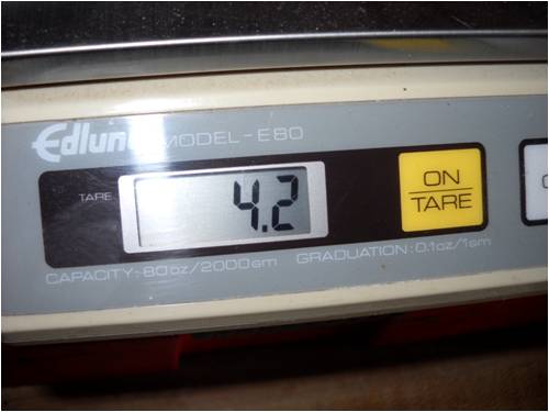

Remember back a while, when I posted a build on "Coroflute" blades? Here's a picture showing one blade on my scale. The blades are both robust as well as feather light and might be something of further interest now that Pets's discovered how much force gets exerted at the hub of our toys.
That's 4.2 ounces for a 4" x 24" blade with spar. Due to different
wood densities, the 3 blades weiged 4.1, 4.2 and 4.3 ounces each.
. . . . . Mac

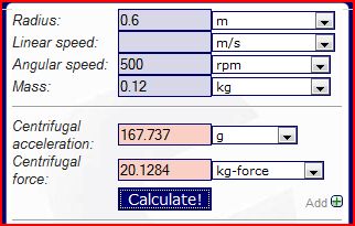

Posted: 11:36pm 12 Dec 2010
Hi Mac,
As light as your blades are it still equates to 20kg per blade force at 500 rpm.
It is rather surprising the mass force applied.
Hey Perry,
I did realize that and why i added the second picture, but as you said ...still a lot.
Pete.
