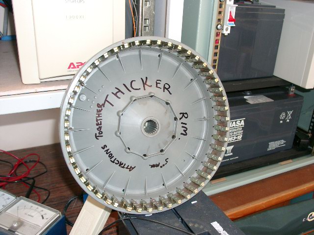

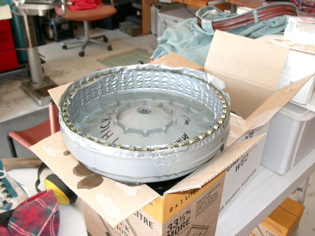

Here are a couple pic's of how I replaced the F&P magnetic"tiles" with 192 small narrow Neo magnets 2 end to end and 2 high.
It's a bit tricky getting them to stay put (do it before the bar opens).
I then carefully stick "Gaffa" tape around inside and outside to form a little "Dam".
Polyester resin is then poured . Minor cleaning up after results in a clean job.
This rotor is very powerful and can't be removed if you put it on without the F&P purpose nylon removal nut.Even then it's a hard job to remove.
I found very little cogging ,just some because doing this job in a home workshop surely dosen't align the magnets %100.. The cogging causes a bit of hum when the rotor is spinning ,I'm hoping not too much. I suppose the cogging is less than %10 of what the ceramic arrangement was.
I'll post aome results of it in a couple of days ,if we have any decent wind.
Here you can see the bubbles caused by the polyester resin 's heat during curing.
These are the 192 small neo's 2x end to end and 2x stacked .
Bruce
