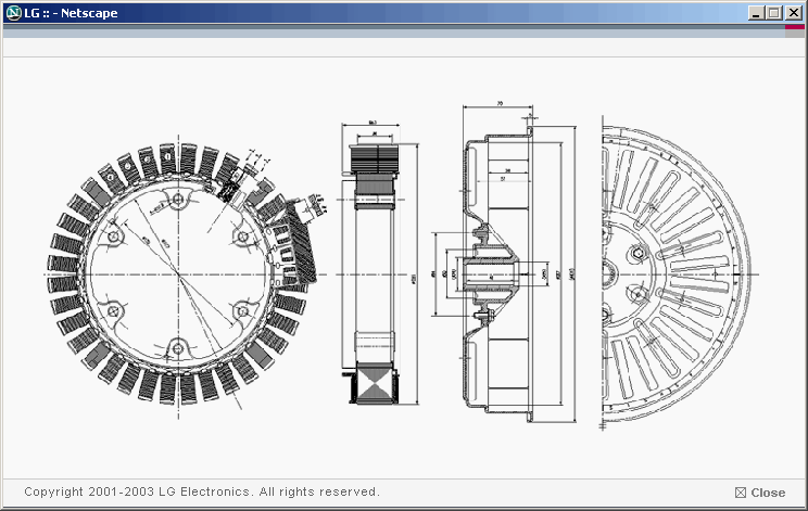

I know L.G do use this motor and what models for sure I don't know. I did look around and didn't find any L.G in the dumps in Canada. Here is a old pic from L.G
Wayne

that is great for showing photo of LG hubs and do you know what size is the shaft as l cant read that writing when l zoom the picture as some ago l saw LG washer machine at lifeline centre and ldidnt not taken any notice of it but looking for F&P and l will go back to few dump in my area if l can get one of LG part hopfully if is any luck if l get one I will post the news

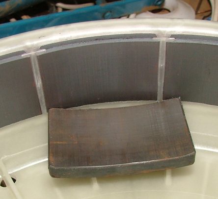

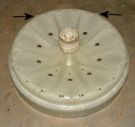

Some photos.
From the back the hub looks identical, except there are 5 lumps, two shown with arrows.
And this is the difference in magnets. A magnet ( actually 4 magnets in one ceramic tile ) from an old hub is shown for comparison. You see the new ceramic tiles are shorter, and contain 3 magnets.
The old stators can be re-wired to suit, and it gives us a whole new combination of connections. I'll play around with these new connection options this weekend.

That LG stator looks like it has 36 poles ,so it will let us have more combinations to work with

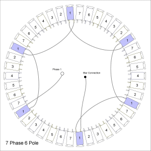

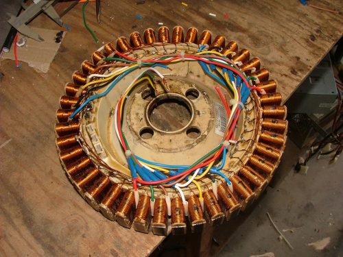

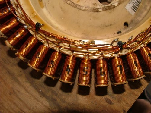

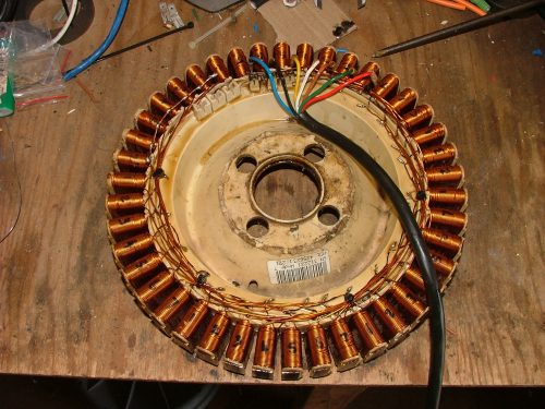

The hub cost $60, pretty cheap. I started re-wiring a stator last night, every pole coil needs to be separated, so you end up with 84 wires ( 42 poles ), then every 7th pole connected in series. Using this 7 phase configuration, we now have 6 groups, which means we can re-wire as 6, 3, 2 and 1 ( the old setup was 14 groups, which gave us combinations of 14, 7, 2 and 1 ).
Its actually a lot easier to re-wire than I first thought, and I'm pretty excited about its potental. This will give us a cog-less F&P, with 4 different wiring combinations. I'll draw up some wiring diagrams this weekend. The only disadvantage so far is because we are using 7 phase power, you really need to mount the rectifier at the windmill top, running 7 wires down the mast would be a problem.

Wired up a stator for 7 phase, its a standard stator, 0.8mm wire, not decoged. Built a 7 phase bridge rectifier. Bolted it to the Lenz windmill. In a slight breeze I was getting 6 volts per phase, all phases equal. No noise, no cogging. Connected up the bridge and battery load, wind picked up a little and read half an amp into the battery.
I've connected up the PicLog and will record the watts over the day, but it looks like its a winner. A cogless F&P.
Its a series connection, so each leg of the phase has 6 poles in series. Later I'll re-wire it as a series parrallel, 3 of 2 in parallel. Then for the real test I'll take down the big HAWT and fit the new stator and hub.
