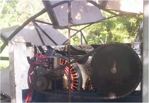

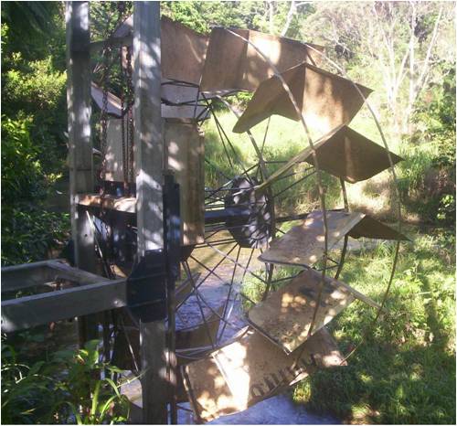

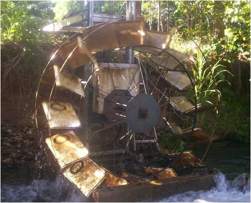

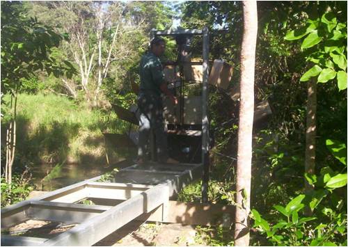

Sorry to put my waterwheel in with your windmills, but a couple of people asked me for photos when I asked a question about using caps with F&P motors. Here are some photos of my setup.
I have been following this forum for a while as I have built an undershot water-wheel which is driving a F&P 80 in star. 7 groupings of 6 coils. The water-wheel is geared R1:48. The water-wheel does 1 revolution every 6 seconds = 480rpm.

1st photo, With the wheel raised the vertical frame and wheel lay down on the horizontal frame, for when the creek is in flood or the wheel needs maintenance.
2nd photo, back view of wheel when raised showing gear housing and block and tackle used for raising wheel. also shows where creek divides with island in centre.
3rd photo, one gear set with chain and F & P motor.
4th photo, wheel in action, you can see the hinges where it swings from this position, also small wall in creek to channel water. The creek is slightly higher than normal in this photo but wheel can be lowered to adapt to the flow.
The wheel is 2,700 in diameter and 1,100 width. You can see my wheel is of light construction, I had not seen a waterwheel before building this and tried to keep it as light as possible so it can be pulled out or moved with ease.
