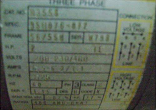

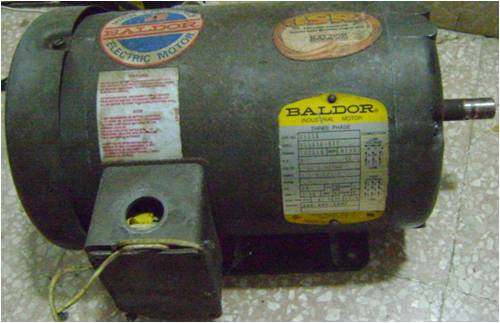

This is the 2hp three phase motor that I will probably use, I do not have a pic of the axial flux alt because I have not started it yet.

hate to be the bearer of bad news charliee but the vawt will need to be 10-20 times what you have now to gear that moter up and drive it and the only way you will get that rpm out of a vawt is with lift or counter rotating. It will be a real showpiece when you are done

Posted: 10:20pm 06 Nov 2010
I will be making an axial flux for the vawt and use this motorfor a future hawt.

I had seen it already and liked the design. I was told that for me to use this motor as a generator that I would have to make a conversion, can anyone tell what is needed in this case to be done?
itsandbits1
Joined: 13/08/2010
Posts: 81
Posted: 05:34pm 07 Nov 2010
you can use the motor as it is but have to turn it very fast; just faster than the rpm it has on the plate. Or you can do the conversion but it will not be very efficient unless you change both the windings and the rotor to make a pma and you still have to find the power to turn it which means a BIG unit. I would reccommend you try a ceiling fan because of the size of unit needed to push it and the good discription of other people that have done it. Or get one of those ficher paykel motors everyone uses and change that. I think everyone on this forum but me has done one or a dozen but me; can't find one, I have turned over at least a hundred washing machines looking. I don't think they use them in the america,s .
