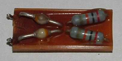

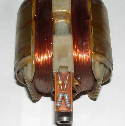

Here are some pics of a brushless rotor that was on a small gas powered genny. First the rotor and circuit board.
I also have a close-up of the circuit. There are two of them, one for each winding.

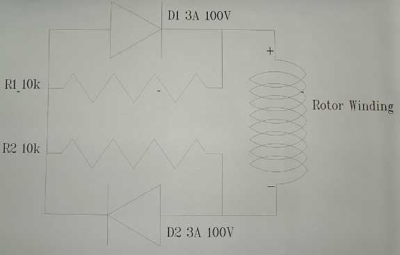

The last picture is the circuit diagram.
The rotor also has two exciter magnets sunk into the laminations 8mmx8mm.
