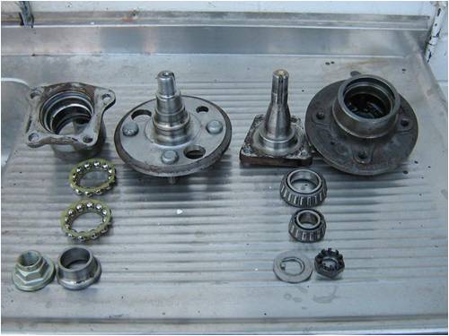

Hmmm! I had a theory that this has already been widely done, so armed with a kit of tools it was off to a local car wreckers that allows the public to remove the parts they want and just pay for the parts when you leave.
After 1-2 hours of disassembling many wheel hub assemblies I finally found what I was looking for….a bolt in windmill part for $13.00 that was made for the job…perfect!!
The one on the left is from a Toyota and the one on the right is from a Holden.
They are the rear hub assemblies from a front wheel drive car.
Many that I pulled apart have the rear brake drum as the bearing mount with the stub axle through it, no good for this application and far to much unneeded weight.
I decide to use the Toyota hub as it has ball bearing races and the Holden hub has taper bearings.
Also I figure Toyota is world wide and would be easier to find for most, but either would work well and both had their own advantages to design.

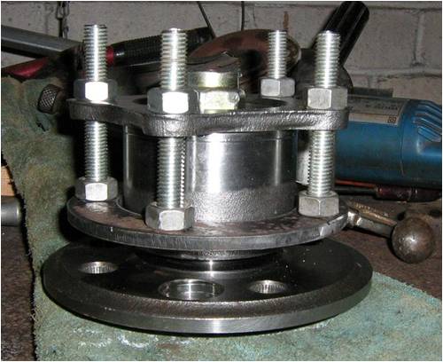

One of the big advantage with this sort of design is it allows for the whole generator to be unbolted from the tower (4 bolts) and no need to disassemble the head on the tower.
This also allows for the complete generator to be changed over if desired while still retaining the same mounting stud Patten.

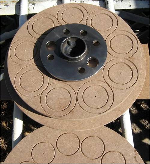

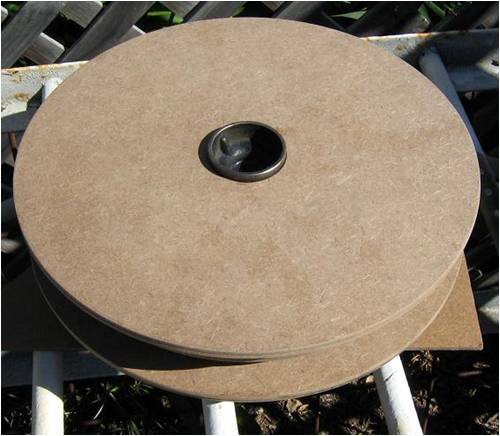

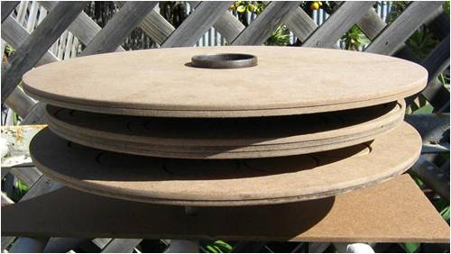

The next step was to workout how and where the magnet plates would locate and the stator size, so I could see what room I had to fit the coils into, and where the magnets would be located on the plates with what clearance everything had and needed.
I had some sheets of Masonite and decided to cut some templates out and stack a few layers to get an approximate size for things.
A circle cutter attachment on a hand held router made this a quick easy job.

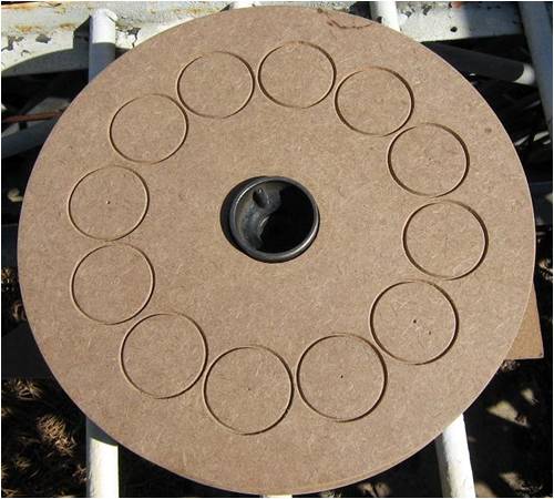

I then marked out the locations of the magnets and coils, placed the masonite discs in the cnc router and engraved the outlines for the coils and magnets.
I am not that good a drawing in CAD on the computer, so this was my way of doing the physical lay up and it allows me to see exactly what fits where.

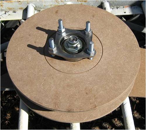

All assembled here but not adjusted in the gap correctly yet.
There will be a series of post spacers to join the two magnet discs together around the outside edge, hence the stator is slightly smaller to allow for these.
Once the magnet plates are both secured together a sheet metal band will go around the complete outer circumference and attach to the post spacers that join the discs together enclosing the generator.
The back magnet plate will have a centre disc cut out of it to allow for the generator to be disassembled from the rear by jacking off the back magnet plate.
The centre disc will remain on the hub assembly to help enclose the generator.
A plate and cap will cover the axle nut assembly and seal the bearings.
The generator will mount from the 4 studs shown above.

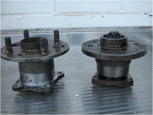

One thing I noticed, in the picture 4th from the bottom, the iron wheel looks as if it might wobble when it spins, due to there being holes on one side and not the other. Might want to take a look at that before you hoist it up the tower, eh?

No problem with balance as there is a matching hole opposite.
Toyota make well engineered stuff and this hub has had 100,000 miles pre-test already done and it hasn't failed yet.

Pete, looking at your MDF layout plates I notice that your magnets are positioned awfully close together. Is there a reason for this? I always thought they should be at least one coil side width apart.
Posted: 11:34am 14 Oct 2010
Hi Klaus,
Yes the magnets are close but that is one of the drawbacks with a 12 inch alternator. (also very tight on coil space)
Sometimes we need to break the rules
Its a trade off between a small loss in flux to a saving in weight.
Being round magnets the loss between each magnet is not so bad as the actual magnet mass area is reasonably small where each magnet meets.
It is not something i would proberly do with square magnets as the area would be much larger and higher losses.
Then others go to pie shape magnets to get more magnet area side by side and then if we look at a F&P they are end to end, i feel if it was such a huge loss in flux then greater magnet spacings would have been used in these designs to.
What i am doing here has all been done before with very good results.
I am happy with not going for the big numbers and am looking for a good reliable mill that is quite and hassle free with 1-2KW output.
My plan is to furl early and live to power another day.
I feel to many get greedy with what the try to squeeze out at the top end and i think the lower half of a mills power curve is the important part.
Pete.
