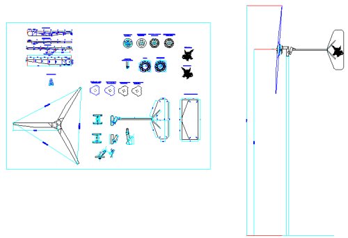

Hello, I'm new to the forum. Since so many people in recent years are passionate about alternative energy, especially wind energy prodatta. For all these people who want to try their hand at building small homemade wind turbines, helping to dispel all the many uncertainties and many doubts, I suggest that my speech to share with you my experience so that it can be useful to all.
I built a horizontal axis wind turbine with 2 ml kWp. 3.80 in diameter with neodymium magnets alternator 30x50 16 +16 N Grade 42 and 12 coils of 75 turns with wire Ø 1.80 mm. The stator is star connected and the system is 48 Volt

In Annex I attach my whole project with Autocad
At this link: http://energiaalternativa.forumcommunity.net/?t=30116645 you will find a precent my realization.

Do you have the Autcad files as a ZIP?

Forgive me here is the file
2010-10-09_191521_Progetto_turbina_2Kwp.rar
IPSA SCIENTIA POTESTAS EST (bacone)
Posted: 11:07am 09 Oct 2010
Almost, here I've done it for you.
2010-10-09_210630_Progetto_turbina_2Kwp.zip
Its a DWG file, very good.
Thanks for posting.

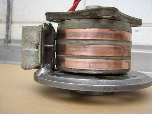

I can only agree with all that has been said, a Job well done. I have built a 500W windmill of similar design but this has inspired me to go for a bigger unit and looking at those nice pictures gives me that extra push (I hope) I have always wanted to include slip rings and you make it look so easy. I was thinking of using car alternator brushes and copper pipe cut into rings cast with resin, but your idea seems repeatable. I will look at the Autocad files tomorrow.

Funny you should say about using copper pipe rings set in resin and car alternator brushes.
I just finished a set of slip rings using all these things.
Pete.

Pete
Could you post more pictures of this brush set-up. How the brushes mount etc. Show the other side, top, bottom, we want it all!

Posted: 07:08am 13 Oct 2010
So as not to hijack this great thread any further i will start a new one called Slip rings with some more photos.
