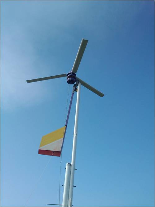

went up to the farm for a look at my beloved windmill.....
Much to my surprise, it was trying to fly UP!
Took a leaf out of Jimbo's book, just because we could!

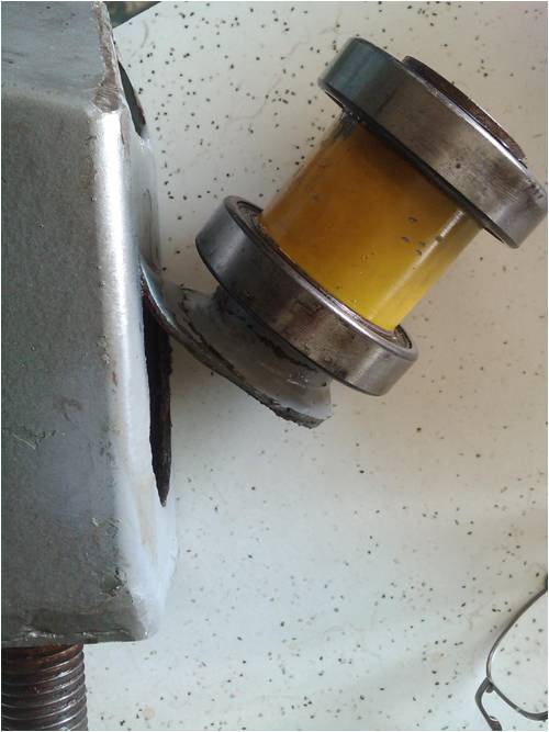

Nature of the failure VERY lucky!! prop going this way instead of via the tower
Datalogger shows 41.6m/s or just under 150KM/hr winds at some short time before the failure occurred but in the words of Gordon the great
"ANY WINDMILL LEFT UNATTENDED WILL FAIL"
this is the first maintenance it has needed, bearings still A1, stators show no signs of corrosion, tail needs a repaint, blades are perfect, still in balance too.
I also note not many 'mills have survival speeds greater than 40m/s and much to Phill's credit he has offered not only to fix it, but fix it better!
What a beast!, destined to fly again soon. BTW 315KW/hrs on the dial so far in 7 ish months.

As we have already discussed the fix which will be to extend the yaw bearing shaft through the box section which will srengthen the failure area to the point where it should be good for 80m/s, hopfully that doesn't get tested.
I think increasing the off-set adj to allow earler furling will also be a good move.
From the pictures it is unbelievable that no other damage was done , I must say though, that the hammering this mill takes in your wind zone and being grossly over powered in the blade dept with the 3.050mt Al blades on a f&p dual, I could only imagine the blades are getting up over 850RPM and the forces it has to deal with in wind of 40M/S ( 130+ KLM ).

Looking at the photo you posted I must agree with Phills comments on the oversize blade being a contributing factor, as the gyroscopic forces of that size blade acting through the critical point where it failed are enormous, the furling of the blades creates these stresses, and making it stronger there will transfer the stresses to the next weaker point of construction.
What it needs is a yaw damper to slow the furling so it isn't wip furling on gusts as that is what is causing the damage.
Karl, you will be aware of the damper used on helicopter blades for this purpose, without it the rotor head will destroy its self in short time.

When you have that box fixed you may want to have it stress relieved, or normalized.
It looks like the crack followed the weld around for a ways then probably the weight took over and started to peal the metal out.

I dont think a damper on the furling would make a difference, the furling is SMOOTH as silk but yes she's really hooting when it furls off, to the point where even furled the power being produced barely drops off.

Karl,
Examine the point where the crack starts with a magnifying glass (if necessary). You may be able to see different grain sizes (increasing in coarseness) radiating out - and possibly slightly different (shades of) colours in some sort of 'concentric circle' pattern.
From the shape of the tear, it is doubtlessly due to re-crystallisation in the weld boundary.

Its an atypical weld failure, ie weld didnt fail, the surrounding material did.
Obviously to tear 5mm thick box section required some very serious loads.
All part of the fun and to say I'm happy that Phillm is taking care of it s an understatement, the fact he stands behind the mills is very comforting.
My initial thoughts were to beef it up and weld it back together, but Phillm came up with a far better idea that will strengthen it up no end.

Im retired from a machine and fab shop that builds from scratch some of those
large Caterpillar truck and end loader frames.
These start out a a sheet of steel and some forgings and parts are cut to print and welded then the are sent out to heat treat and stress releaved then brought back and machined.
When you machine a weld or weld joint you see that the area around the weld looks different than the area not welded and the weld area and weld is harder.
Without stress relief or normalizing this is where the trouble begins.
So the stress and vibration of the wind turbine if possible I would have it normalized or stress releaved.
In welding the weld area gets very hot and expands the as it cools it shrinks this where the trouble is. Depending on the function of the weld joint it may not need to be stress releved or normalized.your weleder man can do this to some degree with a torch after welding is complete.
In handling the sheets of steel we see imperfections in all steel even the certified steel plates you can get a bad one and depends on what country the steel comes from as to the real quality.

i had a good look at box section as is nothing wrong with Phill's welding but bearing shaft should made longer so longer bearing shaft should weld at the bottom of box tube and the top and that where the strenght is however remmeber is only one off no-one is perfect and we learn the mistake sometime however what puzzle me is why you hire big crane cost you a forture instead having a hand winch?

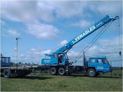

The crane we got as we couldnt actually see what had failed or what was holding on to the mill head.
Hence it was simply a preservation exercise,my mill needs no winch, it is balanced and pivots over for maintenance.
My fear was that if i pivoted it over and the mill broke off and hit the ground OR ME...
we would have been up sh!t creek. This was the safest method to get it down without breaking me or the mill.
Had I known the failure was as we see it here -no problem.
If something different was the case, ie just being held by the wiring which had chaffed away over the previous couple of days might have been a very different picture.
