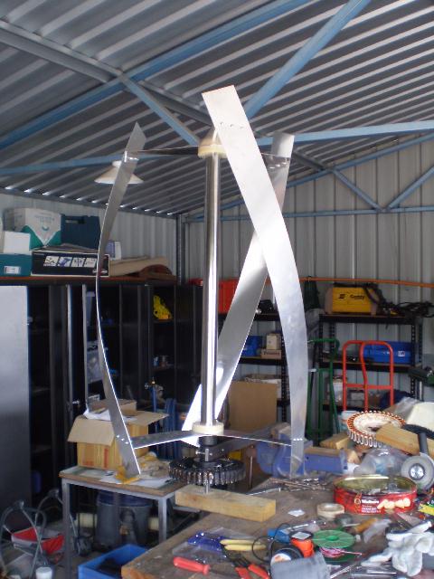

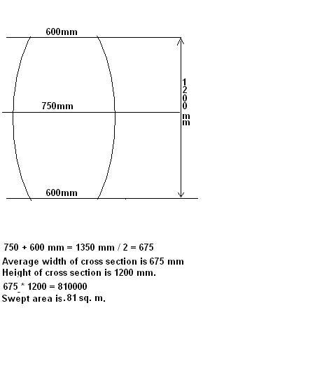

Hi everyone, does anyone know how to work out swept area for my VAWT.
I've included a picture. there are 3 blades which, when flat measure 1200mm X 100mm. The diameter at fixing points is 600mm and in the middle is 750mm.
I cant try it out because when making the 'C' frame I forgot to allow for the extension of the blades beyond the fixing point, anyway no wind today.

Thats a beautiful piece of work that you have created there. Please keep the pics and story going when you sort the frame out .
What stator/rotor config are you using ?

Very nice work I am glad to see the VAWT being promoted as there has been so much negative said about them.
All the best

Thanks guys it's not my design entirely , I saw three of these on top of a 6 storey
building in the U/K and took some pictures, the actual ones at a guess were about
3metres high. The stator on there at the moment is wired for 24v low wind, until I know how it performs I can't decide. Hope to have it going at ground level next weekend for trials.

Now thats a try piece of mechanical windmill art, it looks great
It even looks as though it should work, and should it not preform as desired will still look great as a yard feature.
Look forward to seeing the results once you get it flying.

Swept area is only used on HAWT's. What we really need to work out is the area facing the wind, so for a HAWT, we can use swept area to work out the area of the turbine, since its facing directly into the wind.
For a VAWT its different, cause the turbine is side on to the wind. So we need to work out how big the side of the turbine is. Using some approximations, your width is about 700mm, and your hight is about 1200, give or take. Thats a area of 700 * 1200, or 0.7 * 1.2m, about 0.84m2. A HAWT with a 2 meter diameter has a area of 3.14m2 as a comparison.
Its a nice looking turbine, but I'm afraid to say your going to have a couple of problems if you want to use it with that F&P motor. First up, that design doesn't have a lot of startup power, and I think it would be lucky to overcome he cogging of the F&P, unless you go for a cogless 7 phase or later model 36 pole motor. You may have to attach a pull rope to get it started. The other problem is it wont make a lot of power once running, due to its small size, and the F&P will waste most of it in iron losses.
However, it should work very well with a smaller alternator/generator. A DC treadmill motor comes to mind, I think it would match up well to that turbine.

Thanks Greenbelt, spot on.

the calculation is fine until you take into account the other 3.14 because once it goes into lift it produces power all the way round

the circumference. the vawt is much more limited by the type of blade i think because it has so much more blade area. But it also has as a benefit the full rotation of the blades to get lift from once it is in the lift zone as it gets pushed around the circle. the high efficiency models I have heard have a runaway lift preventer brake to stop this from going too far. It is the same as the hawt blades; if you watch them you can see when they get lift and take off.

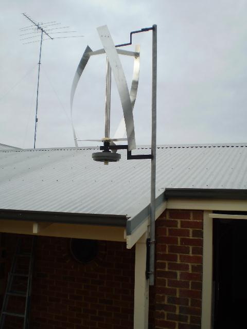

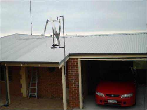

I have just finished putting the VAWT up, this is just a temporary position for it
as it's close to the garage, where my battery bank is, as usual, no wind at present,
but we have had strong easterlies the last three nights, the stator is not on as yet,because I'm waiting to see how it performs, will update tomorrow if I get some results.

Yea, that should be good for another 500 watts at least. should put it on a tipping pole and get it up above the roof line at least. the wind is gonna hit the house and the underside of the portch and really get slowed down and messy. The vawts can deal with it but you are going to loose a lot of power.

Well have had some strong easterlies recently with really strong gusts and guess what? It did'nt budge not even when I tried giving it a helping hand. It looks just the real ones that I saw in the U/K, and it's in propotion, just cant figure it out.

I would think it is a combination of two things , the blades being flat aluminum are not aerofoils in there design and are not creating enough lift and drag, the second is the cogging effect of the F&P, unless you have used one of the coggless 7 phase mods, then that could be discounted.

I'm afraid a 2m diameter F&P will do 300W if you're lucky hence at 1/4 the swept area
you're looking at ~80W.
I wouldnt be doing any re-wire at all and a 60S stator would be the pick.
If it runs faster than expected then a quick jumper into delta might solve it.
next step would be the 80S again I'd try unrewired first.
Blade at its extremity facing the wind should have an angle of attack of about 5deg.
if there is little or no angle it will never start.
Twist those poles on the stator and round the edges of the poles as well, this should make it almost cogless without re-wire to 7 phase and another magnet rotor.

I thought you said somewhere those were helicopter blades. they should have some airfoil if that is the case. if you spin them up to close to tsr1 with a stick they should take off somewhat even if they are flat in a stiff; 20kph-up breeze. I run my symetrical naca0015 modified blades at 0 degrees aoa and that is the sweet spot for them . they are all different though. a test was just done on the naca4415 at 8 degrees aoa and it almost made the betz limit so you never know
