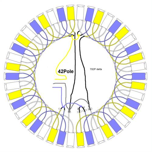

Can anyone in the know check that I have this wiring correct please?
7 poles in series and 2 parallel – delta (7S2P delta)

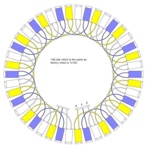

and the other stator is ment to be 14S Star.

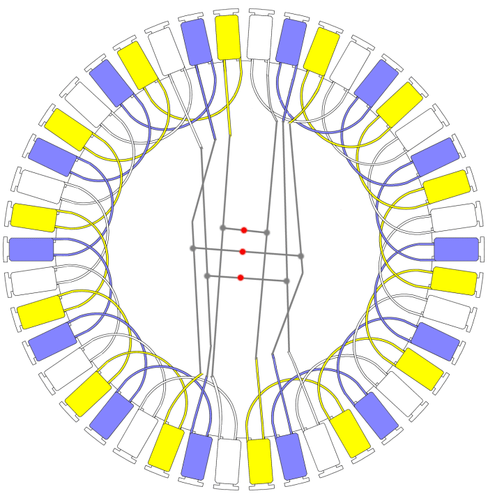

I think the reason you didn't get any replies is the drawing you put up is wrong and drawing these diagrames takes a lot of work and time. Besides, some posts here will get many hundreds of views per post.
I've done a simple diagram, the red dots are the output onnections.
Let me know if it doesn't make sense.

Thanks Gizmo, yes that makes perfect sense.
It looks like I had the right idea electrically but the delta wiring the way I had done it would not have been in phase. eg I joined them at the wrong end. Or not electrically balanced for want of a better description.
Was the second diagram correct?

PS Edit the second picture in your original post is as standard from the washing machine, and yes is 14S starEdited by Trev 2010-09-18
