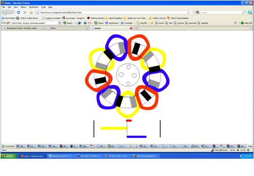

As for using round or rectangle magnets, I've used round and had some problems. A round magnet makes "cancellation" a real risk and you have to size the coils very closely or it creates problems. I'd stick with the rectangle-shaped ones if it were me.
I haven't looked at your pdf file yet, but the general rule is make the hole in the coil about the same size and shape as the magnets. Space the coils a distance equal to about half the width of your magnets.
The ideal magnet placement shows a ratio of 4:3 -- magnet : coil using 12 magnet pair and 9 coils. This gives the near-perfect geometry so as one leg is falling in voltage another leg on the same circuit is coming up and so on, making it generate as much as is physically possible each rotation.
Here's a .gif file that will demonstrate that harmony.
As for how much wire to buy, get any size wire to make a "test coil". Once the magnets are placed on each wheel and the infrastructure is such that you can spin the thing at a known rpm, do that with a coil of say 30-gauge enameled copper wire with 200 turns. This will give you a very accurate "turns per volt" number. Jot that number down and then when it comes time to make the actual "operating" coils, you'll know how many turns for each coil and it won't be guesswork.
The wiring configuration becomes an issue when it's all said and done as well. If you're going to charge a 12-volt storage battery and are doing a "traditional axial-flux design" then you'll wire three coils in series, with each coil 120* apart. Do this three times and then take one wire to common with the other three to each of three phases. Doing it this way, shoot for approximately 1.8 vac on your test coil. Any less won't make cutin and any more will serve only to warm the stator. This method by the way is called "star" and there's another method called "delta", which will up your amperage if you need to.
That should be enough to chew on for a while.

I took a look at your PDF and it resembles the turbine shown in this Link.
It looks okay so far from what I can see. As for the order in which to start, I'd start with the magnet-flux-return plates. They have to be thick enough to divert all the flux from 12 magnets back and forth without losing any. To test if you've got a thick enough piece, see if a paper clip will stick to the back side once all 12 magnets are in place; it shouldn't. If it does, the plate is not thick enough for your magnet choice.
You'll need two plates, each with 12 magnets distributed in the order given in your PDF. The inter-magnet spacing seems a little close near the inside edge, but as long as you are able to fit your 9 coils into the mix with the proper inter-coil spacing over the large end of the magnets, the fact that the tops of the coils are a bit crowded together shouldn't matter much. The relative speed (feet or meters per second) is slower there and the amount of electricity produced is far less than where the magnet-to-coil speed is higher. I wouldn't worry about it.
Remember that the stator will be "suspended" from brackets so it is positioned between the two magnet wheels. The wheels rotate while the stator stands still -- BUT the alignment of the stator against both magnet wheels must be held to tight tolerance. There needs to be a very small air gap, but not so small it allows physical contact between the whirring magnets and the stator or it will self-destroy in a jiffy.
So, get the plates, then the magnets, then some acetone, then some CA glue then some enameled wire. Once you've got two plates of magnets spinning around a center core (hole), get back to us and we'll proceed.

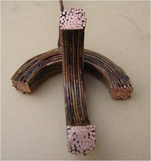

I would say wire size 14 would be better but its a matter of what you can get your paws on.
It all comes down to filling the area permitted with as much copper as you can while maintaining the right number of turns.
If that means 1 strand or 6 strands it don't really matter as long as they are all wound together and it fills the area for the turn count needed.
A loose wound coil is prone to failure, unless its totally impregnated with resin the copper strands will vibrate with the magnets passing and eventually wear through the enamel coating and short the turns.
Just winding a coil and casting it in resin is not good enough, as the resin will not soak into the coil and will trap air in the windings and allow the copper to move internally.
You only have to look at the amount of stator failures with burnouts and from pictures posted it is always one coil that takes the phase out.
Why is it one coil or one phase? because of a construction problem.
Any other reason it would take out the whole 3 phases not just 1 or a single coil.
Ensure ALL coils are placed in the stator with the coil windings ALL going the same way. If you flip a coil over it will cause problems.
If it takes you a week to wind the coils so be it, just get them right as they do all the work.
Pete.
