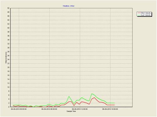

Posted: 12:23pm 06 Sep 2010
Hi Phill
It is working good now, the wind was gusting to 5 ms today and the mill was makeing between 150 and 300 watts.
As you can see it didn't last long but it proved the point, it rained all weekend so no wind to speak of there.
All the best
Foolin Around

VK4AYQ
Joined: 02/12/2009
Posts: 2539
Posted: 12:37pm 06 Sep 2010
Hi Amak
I plan to get it on the logger but the priority is to get it up and running at the moment, as you can see from the wind chart Im not blessed with wind like your site so may be unimpressive compared to yours.
As for the logger and the on line part it may be well beyond my capabilities with the computer to get it going, time will tell on that one.
