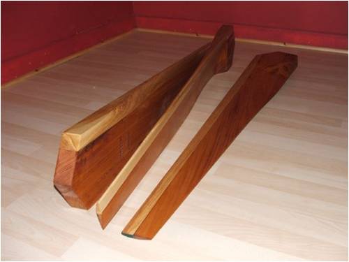

ps. Nice set of blades there naillEdited by Gizmo 2010-09-08
