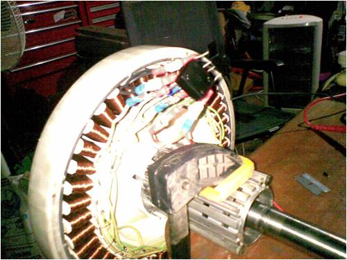

I took your advice pete and wired in the rectifiers still only using 2\3 the power output (thanks dick smith only having 2 rectifiers) Then loaded it with a handful about 15 100k resistors (they popped but it was fun to watch) my poor drill didn't like it much either it looked to be running at around 50 - 100 rpm putting out about 6v didn't get time to test amp's need a better load controller will put something together and do some more testing
Here's a pic of the test unit sofar
I know its rough but it works
I'm also thinking of making a coil face plate for the test unit the face plate will be a bread board of sorts so i can chop and change coils (without the need to solder all the time) to find the best results and tune the stators to the mill.
