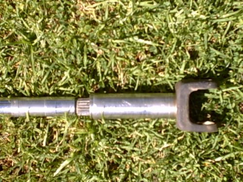

Just got a email from Dennis, he's found a spline that suits the F&P shaft.
"After looking at hundreds of cars and parts (many hours) BINGO. Early type Toyoto Corollas and Coronas have female tail shafts which match F and P perfectly. The axles are long males which also match. I go to a wrecker where you take the part of the car yourself and only bought the yoke sections after stripping from the universal joints. There are lots of them and they cost $5 each. They have an outside diameter of 32 mm and will cut up to 80mm long and this is the way to go"

Yes l have known about this for fews months ago and did taken the photo however fail to load to Gimzo's webs site and when l found out when l use the Toyoto Corollas motor for my 3ph genator and did cut gearbox bell housing in half and weld 3 flat 12mm plate to match and bolt it up bell housing direct to corolla motor and gearbox part was use to make felixable coupling on genator shaft and the flywheel and l relize that gearbox shaft nearly fit to F&P hubs and need a bit of lathe work to reduce the outside diameter so it will fit into the hubs same with tailshaft female york that fit nearly 80% to F&F spline so l am bit sorry for not telling everyone earlier
