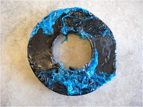

Here are a couple of pictures of my latest endeavor. I'm building a magnetite-filled solid stator ring, which will be machined (once I figure out all this casting business) to hold coil windings much the same as an F&P does with laminates. Magnetite has no hysteresis and is free (magnetic beach sand); the perfect match.
This shows the stator core already popped out of the mold. The plastic
wrap sticks to the resin (I used polyester resin here), but it peels off
without difficulty.

As you can see, I missed it a bit on this one; again -- learning curve. This iron-filled donut gets machined, but unfortunately the inside (where I boogered it up) is already nearly to size and has to pop out of the mold not needing machining.
I think on future castings, I'll smear Vaseline petroleum jelly on things before I flop in the plastic wrap. That way, I can use a sponge or Q-tip to get the corners and edges tight before I pour in the resin. Sooner or later, I'll throw up a post showing the whole process, but I thought I'd share now what I've learned so far.

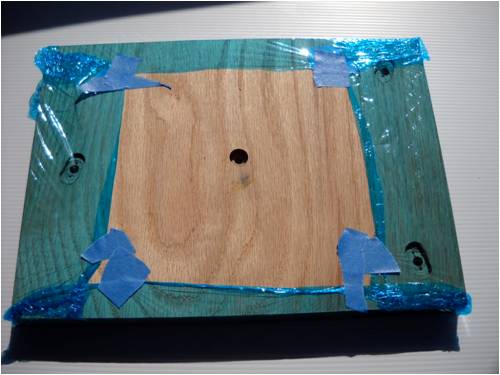

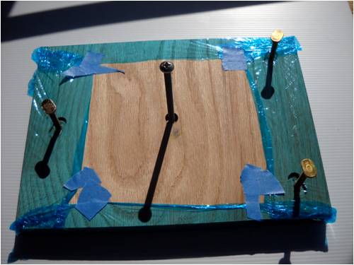

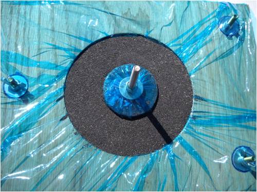

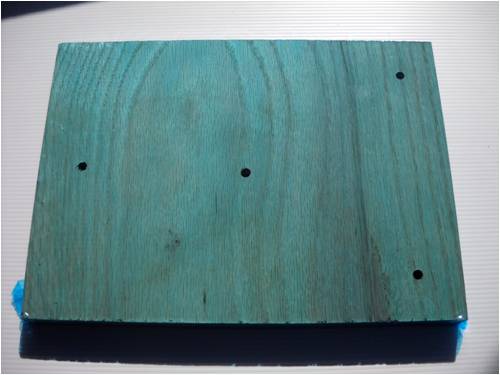

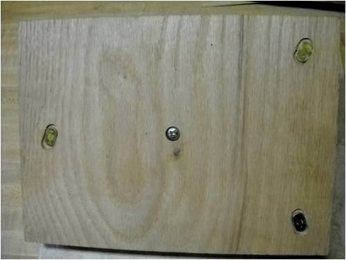

First off, I covered the face of the red oak wood mold with blue plastic
sandwich wrap and taped it to the back, smoothing out the wrinkles:

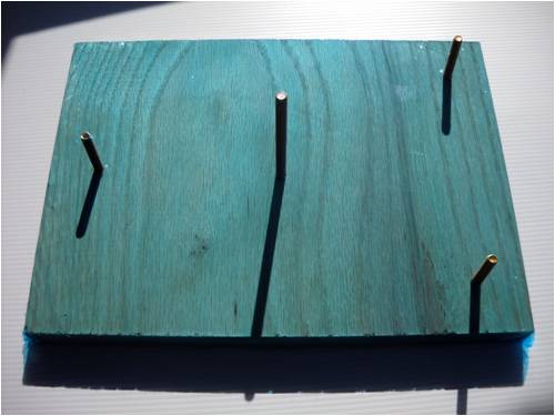

Here's that back side. I used blue film and blue tape so folks could
see things better. You can use any color or no color.
From the back side, I then jammed all the bolts that clamp the thing
together through their respective holes.
This is what they look like as they come poking through the top side.

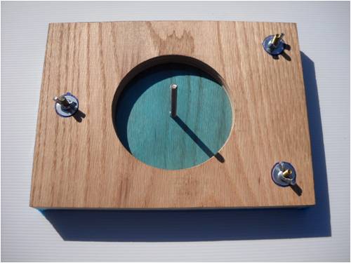

Next, I fitted the top half of the mold over the pegs and cinched all
the wing nuts tight.

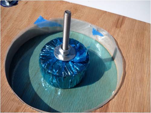

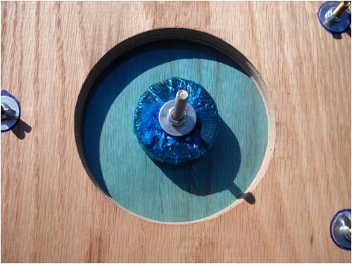

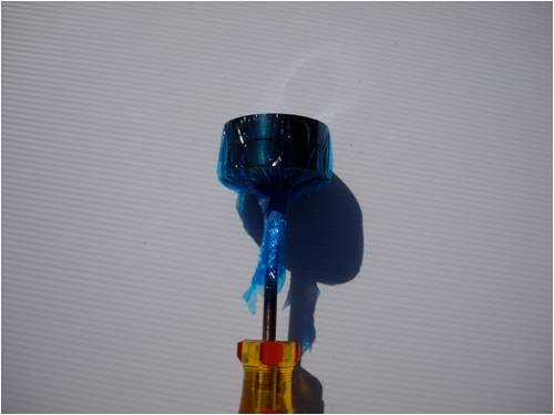

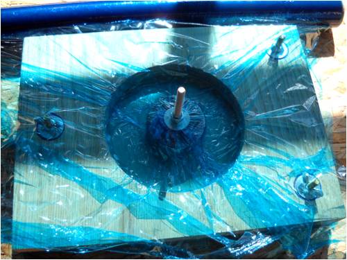

I then wrapped the center spindle with film and taped it closed at the
top after getting as many of the wrinkles out first. I think I'll use wax
paper on future builds as the film is too thin and it was hard to remove
the plug after the resin cured.

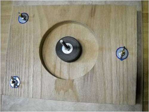

The center plug was then slid down over its hold-down post and the
nut was tightened over a washer to make things good & tight. That
reminds me of a joke: What is the German word for virgin?
Gootundtight!
Next up, I cut a strip of wax paper the same width as the thickness
of the mold's top half and taped it in position with blue tape. Future
builds will use two layers of wax paper, as this first casting took a little
more than "friendly" persuasion to get it out of the mold!
Next, I draped another sheet of sandwich film over everything and
tucked it into the corners with a Q-tip and pencil eraser. This is to
allow me to pour in magnetite powder until it's full, so I have enough
and the casting doesn't come up short.

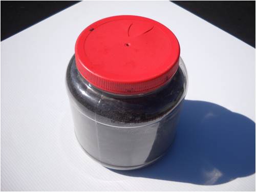

This is my jar of magnetite. It's a plastic quart jar intended for peanuts,
but I use it for magnetite. It weighs in at around 35 pounds when
full. Even though this stuff is "free" at the beach, it took me about 10
hours of trapping and refining to get it pure enough to use in a stator.

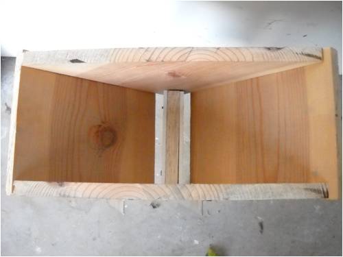

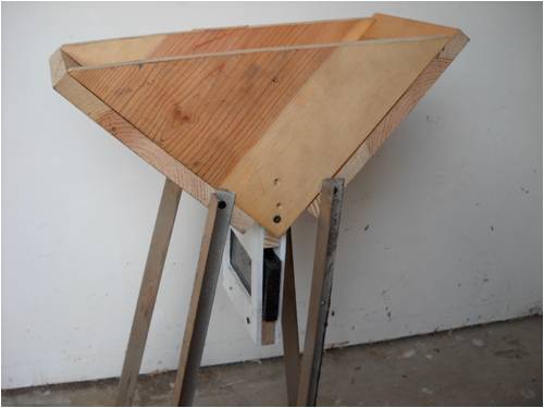

I built a contraption that holds a large ceramic magnet under a stream
of sand that pours down through two slots of an 8" x 16" wood funnel
into which I pour dry beach sand. The thing stands on 4 little adjustable
legs.
Here's a picture of it from the side. That big square black thing is a
flat ceramic magnet that catches magnetic sand on each side as it
pours past, mixed with the blond sand.
Here's a view from the top. The "funnel" is divided into two halves,
separated by the magnet hanging at the apex (bottom). As the sand
makes its way by gravity to the opening, half falls on one face of the
magnet, while the other half falls past the magnet's opposite side.
The magnetite has no hysteresis, so it sticks equally well to either side.
When you shove it from a north face to a south face, it doesn't care.

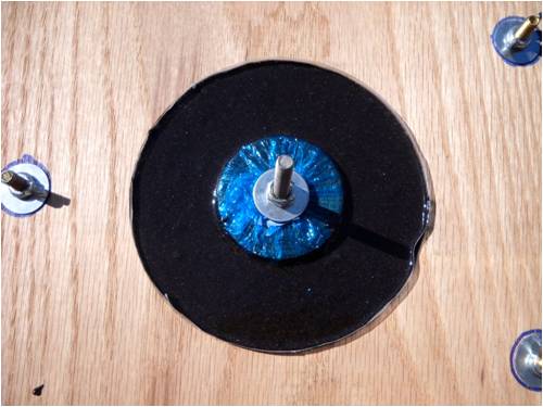

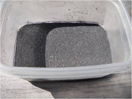

Here's a shot of that over-laid sheet of film holding enough dry
magnetite to fill the space.

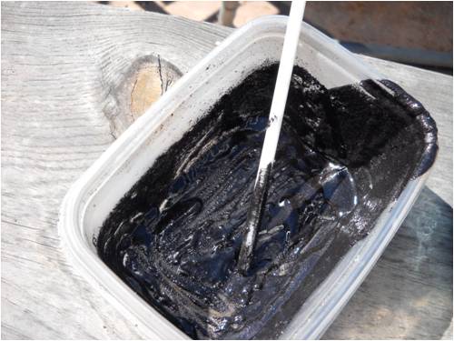

I added enough liquid polyester sanding resin to make the mixture the
consistency of brownie mix, then added more until it was like cake mix,
then a little bit more to make it barely "runny". I then added 26 drops
of catalyst. I was going only for 25, but an extra one dropped in at
the last second. I didn't take any pictures of the mixing phase, cause
I didn't want to take time, fearing the mixture might decide to "go off"
before I was ready. So, anyway, this is a picture of the mixing cup and
plastic stir rod after I had poured the mix into the mold:
And here's the mold holding the magnetite-resin mix sitting in the
warm sunshine curing.

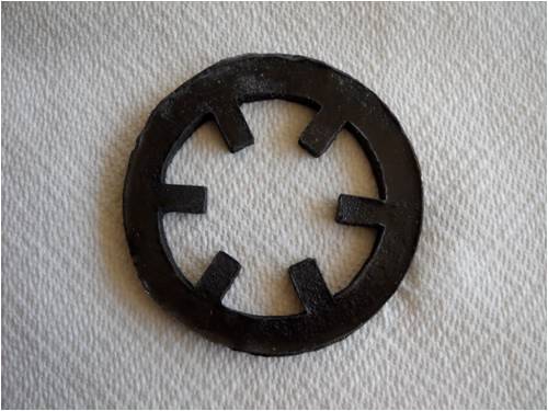

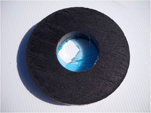

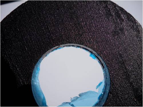

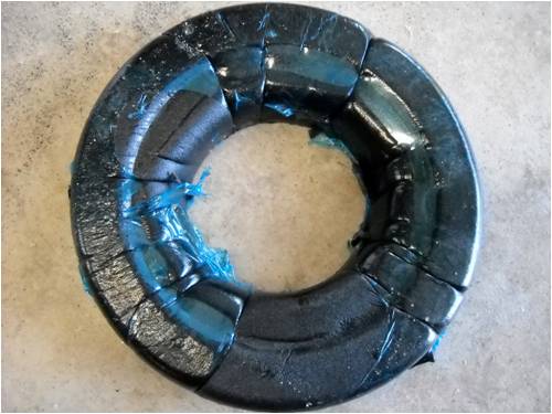

After about a 3-4 hour cure in the sunlight, here's what popped out.
I should explain that in actuality, it didn't exactly "pop" out. Next time
I'm doubling up on the wax paper and lining the center plug with two
layers of wax paper too. This time I had to bang on my creation to
get it out of the mold. Kinda like spanking the hell out of a newborn!
Notice the crisp, clean, straight right-angle sides. This is exactly
what I was after. That inside hole is a bit too small for my magnets,
which allows me room to zero in on it with my lathe. By cutting this
to its final size, I can assure the smallest air gap possible.

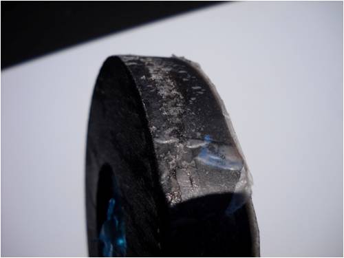

Here's a tight shot of the outside edge. That wax paper will peel right
off. The outside doesn't matter much except maybe for looks. It's the
inside where it matters. I'll wait until tomorrow before I machine in
the wire lands, allowing things to cure for another day. It smells pretty
strongly of polyester resin still and may be soft in the middle (like me!).

Edit: I added a couple pictures of the magnetic-sand gathering tool I built.

Future pours will see two layers of wax paper around this thing, which should allow both enough room for expansion (if any) as well as a small interface between the wax paper layers. That should afford me enough slippage to get it apart more easily. I purposely made the center spindle smaller than the final inside diameter so I could machine it to fit the magnet rotor.

I've made a few changes to things. I figured out a way to make the center "plug" mold out of rubber mat, so when things cure, all I have to do is pull it away from the edges. Being flexible, it just comes out of the mold making the mold ready for a new pour.
Future molds will be constructed from all-rubber sheets laminated together. There will be one mold for the outside and another for the inside. The two halves will fit together. Magnetite-filled resin will be poured in between the two molds, so when things go off, the two mold pieces will simply get peeled away from the finished product.
Make any sense?
I've heard it said a picture's worth a thousand words:
Ta-da! This is the latest to pop out of the mold. The little spokes
will get wrapped with enameled copper wire and become coils, which
the magnets will whir past. Future cores will be made so there is a
dimple where I'll drill the mounting holes. Those holes will serve to
both hold the core to my lathe's face plate so I can machine the central
hole to the correct size, creating the thinest air gap possible, as well as
hold it to the actual windmill when it gets that far. Also, I've cut down the
coil count from nine to six in hopes to better-accommodate the 6 magnets
on the spinning central shaft. There will ultimately be three coil cores, each
off-set from the other by 1/18th of a circle, so as one set of magnets is
on top of its respective coils, another set is just arriving and yet another
is just leaving its coils. This is an attempt to counter the cogging effect.
