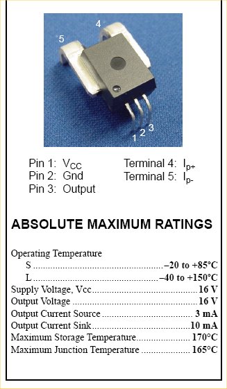

As im sure you would know im going to use the ACS750
I assumed that cap and zener and 1k to the neg leg of the shunt be removed   ????
And that the ACS 750 current sensor
Pin 3 be connected to Pin 6 of the PIC
Pin 2 to ground
Pin the to the 5 volt Vcc rail if the board
And Legs 4 - 5 on the V- of the bat
Thanks Bevin
Posted: 04:36am 21 Sep 2006
Hi Bevin
Those conenctions will work fine. You could also put Pins 4 & 5 on the +ve side of the battery, as the ACS750 is isolated internally.
The 4.7v zenner and 1k resistor are there to provide some protection to the PicAxe input pin. If the pin voltages goes above 5 volts then the PicAxe will be damaged. But if you run the ACS750 from the +5 volt supply, then its output should not exceed 5 volts and work ok with the PicAxe. However if the ACS750 is some distance from the PicAxe, then spikes on the leads could still damage the PicAxe. I would leave the zener and resistor there myself for extra protection. The capacitor smooths out any erratic current changes that may give "jumpy" amp readings.

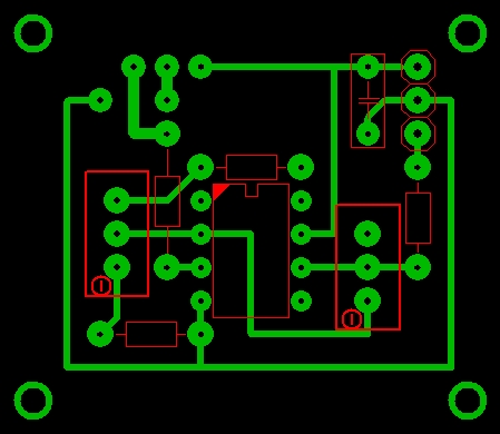

Posted: 11:51pm 04 Feb 2012
Can someone please conform this..it took me all day....to make......Edited by scnarine 2012-02-06
Posted: 11:36am 06 Feb 2012
Hi Sudesh
Had a quick look over it, I think its OK. But I could be wrong, I'm a bit tired

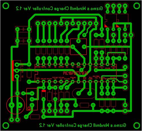

Posted: 12:11pm 09 Feb 2012
@Glenn, I will use the toner transfer then etching....but also trying to learn how to use a CNC mill... Here are the Sprint Layout files power board not completed..2012-02-10_035842_Gizmo's_Windmill_Charge_Controller.zip Edited by scnarine 2012-02-11
