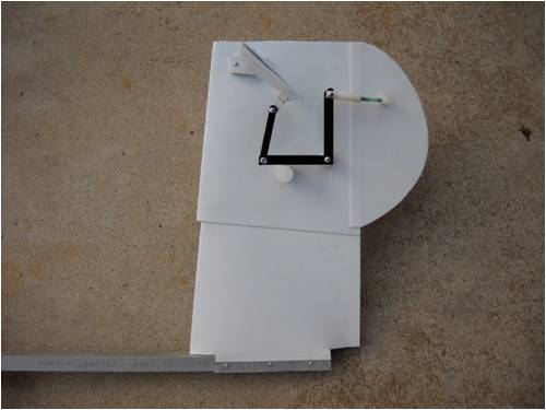

This is that same little "test" mill I have flying in my back yard. I merely
rebuilt the vertical tail section for this project. The stabilizer rests in a
"drag" position 45* to the wind. As the wind speed picks up and goes
beyond a preset minimum, the stab rises (against a spring not shown)
and the rudder kicks to starboard.

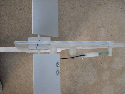

Here's a closer look. For anyone familiar with R/C gliders, I just added
a "full-flying" stab (horizontal stabilizer) to the existing vertical stab (tail)
and am using its action in the wind to move a rudder.

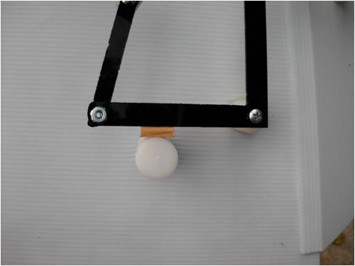

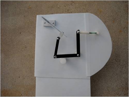

Here's a shot looking down over the top. As the stabilizer moves, it
in turn moves linkages that ultimately turn the rudder, turning the mill
out of the wind and slowing things down. When the pressure on the
bottom of the horizontal stab lessens, a spring returns the rudder to
"amid-ships" (center) and the mill points directly upwind again.

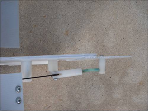

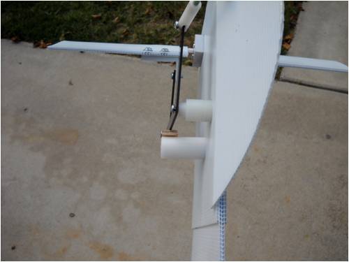

Here's another shot showing the rudder at "zero" as things sit at rest.
I propped a 1/4" piece of wood between the "stop" peg and the arm
of the bell crank to show how much this reacts at the rudder (next
picture).
Just that small amount of movement in the stabilizer kicks the rudder
hard enough to turn the mill out of the wind lickety-split! It's too late
today to shoot a video (along with no wind) but tomorrow, I'll fly it and
stick a video on Youtube and either put a link here (if the edit function
works) or put one in a reply.

Mac, have you flown this yet? I am curious as to how far (in degrees) this configuration will furl the mill off the wind before the tail stalls or the horizontals become ineffective.

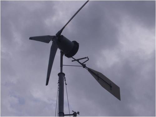

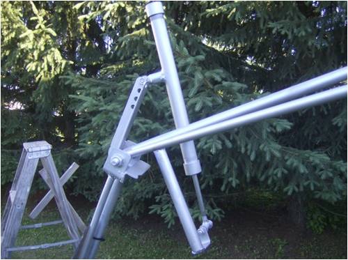

My last turbine I built uses the standard furling tail, albeit with the tail hinged in the center of the boom, and controlled by a spring over hydraulic cylinder. This is a photo of that machine on the tower:
And this is a photo of the tail hinge setup with the tower lowered:
This is probably the smoothest and most reliable furling mechanism I've built to-date. The internal hydraulic damping in the cylinder allows a minimum stop-to-stop time of 3 seconds, which dampens the forces on the tail in high winds. The cylinder has three different adjustments: "breakaway" - or where it starts to furl, maximum furling pressure (set according to maximum continuous output of the generator), and damping speed (minimum 3 seconds stop-to-stop, maximum 5 seconds).
I have flown this setup in 111.8 mph wind recorded by the anemometer on the tower, without shutting the turbine down, with no damage to the machine.
The main reason I developed this setup for this turbine is because it is a rear generator unit with a PTO driven generator and the conventional method of hinging the tail on the yaw tube didn't allow enough tail movement to prevent the tail boom from contacting the large rear mounted generator. This is a 13 foot turbine and I experimented with a rudder type system but found that the surface area of the rudder had to be considerably larger than the vertical stabilizer or as soon as it started to yaw the wind pressure on the stationary portion of the tail won out and the machine would not furl. I suspect you'll find the same thing with this design.
On small turbines you may be able to get away with this, I don't know. But on larger ones the rotor will develop close to full power in high winds running at 45° to the wind and the power output does not drop appreciably until the rotor is turned 60° from the wind direction, minimum. At 75° to the wind direction, in 100+ mph winds you will still see upwards of 4-5 kW from a 13 foot rotor and the only way to get it to slow down at all is to design the furling system so it will turn a full 90° from the wind direction and keep it there. At that point the tail must provide enough control over the rotor at those wind speeds to keep it from swinging downwind and having a runaway with the rotor running in reverse.

To answer the questions so far:
No, I have not flown this yet & yes, it'll likely only work for a small-ish windmill. Fortunately, all I build is small stuff, so I suspect it will be fine for me; not sure about the rest of the crew. If there's wind tomorrow, I'll fly it and post a video on youtube.
Future builds will see the mechanical stuff housed inside the vertical stabilizer (hidden from view). I will still use a full-flying stab, but the trailing-edge cross-connector rod (which ties the aft end of the stab) will control the bell crank directly. There will be a small horizontal slot near the bottom of the vertical stab which will have the exit horn from the lower portion of the internal bell crank to which will be attached a flexible linkage that is tied ultimately to the control horn on the rudder itself.
Since my stuff is all really small, I design it to run at very high speeds and all I'm looking for is a way to fall off the wind "just below" the windmill's red-line limit. I don't think one of my tiny machines would come apart in a hurricane, so like I said, all I want it to do is fall off a bit at or near its top end.
I'm also thinking instead of using a spring (which would be subject to corrosion from weather) I'll merely weight the trailing edge of the horizontal stabilizer with a strip of lead and let gravity do the work. This may not work due to any vertical vibration induced by the fact that the stab is constantly trying to dip the nose, but that's just something I'll have to watch for I suppose. I'll update this post as I make changes and find out more about how well (or not) this set-up works.
Edit: OH, I almost forgot one very important thing. My windmill builds incorporate stops at 180*. What this means is I physically stop the horizontal rotation of the windmill 45* off center each way from the "mean" direction of wind-flow. What this boils down to is my not having to worry about electric wires wrapping around my tower due to the windmill revolving round and round with changing wind direction. It also means if the mean wind source changes up more than 45 degrees either way, my windmill doesn't stay in its direct path. Oh well; can't have everything, right?
. . . . . Mac
By "horizontal rotation" I assume you mean yaw.
I guess I don't understand the yaw stop arrangement here. 45° either side of the wind direction is 90°. If you consider the "mean" wind direction to encompass a 45° sector, then 45° on either side of that adds up to 135°.
Or maybe I don't understand what you're saying here.
This setup you invented is very cool looking indeed. But I think what you're going to see here is that when you use a passive yaw control system to steer a turbine and try to switch it to active yaw control to furl it, that forces are introduced that you may not be considering. One of those is gyroscopic precession forces. I don't know which way your rotor turns, but judging from the photos it appears that this turbine will furl right view from upwind. If that's the case you need a rotor that turns left (counterclockwise) viewed from upwind so precession forces can assist in furling.
The other thing is the tail design. It takes a LOT of rudder area to steer a tail with a stationary vertical stabilizer. The rudder can try to deflect the tail to the side, but as soon as that vertical stabilizer increases its angle of attack it starts making lift, and it won't turn any further than the point where the lift from the rudder balances the lift from the vertical stabilizer.
Chris

Oops! I meant 90* but didn't think it through when I typed it up. Ben was right; 'Haste makes waste'.
At any rate, the prop spins clockwise facing the wind, so I made the linkage kick the rudder pedal to starboard (right-side when facing into the wind flow). I wasn't actually thinking in terms of gyroscopic precession, but my years of flying R/C just kicked in and this "seemed right" to me at the time. Thanks for the science behind it.
I think this would be a good place to restate some facts: MacGyver is a plumber NOT an engineer. I like to think of myself as an engineer, but the reality of it is I can't handle the math. Heck, I keep way more money in my checking account than I should just so I can let it balance itself each month! Now everyone knows what we're dealing with here. Just thought I should clear the air a bit.
The longer I stare at what I've built, the goofier it looks, but it was fun to think through and build, which is 99% what I'm all about anyway.

The wind finally kicked up to what I thought was enough to operate my little furling idea so I shot a short video.
Here's the Latest Video of my attempts at a furling device.
Fiddle sticks; it worked so well on paper!

You mentioned something about the horizontal stabilizer being in the "wind shadow" of the blades in your video. I'd like to point out, Al, there is probably no wind shadow behind those blades. It doesn't appear that you're driving anything with it, so the blade are just coasting.
In order to slow the wind to create a "wind shadow" you have to extract power from it, which means the rotor has to be loaded.

Perhaps I misspoke (not uncommon for me). What I meant was that the blades, when they are whirring around, present themselves as somewhat of a "wall" standing in the way of wind just gliding through that plane (where the horizontal stab is currently mounted).
I've proven to myself this is likely not a viable build, still I'll try it again by moving the horizontal stab down to the hub level and creating a full-length rudder up the back side of the thing just for drills.
That's unlikely. When the blades aren't loaded they present virtually zero resistance to the wind flowing thru them. I've run 10 foot rotors in my shop with a makeshift arrangement of high speed fans to simulate a 3.5 m/sec wind and when they're not loaded a handheld anemometer shows no difference in front or behind the rotor. Put a load on the generator and there's a significant difference from front to back in the measured wind speed.
