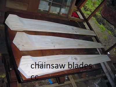

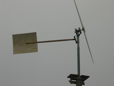

Hi all my first mill is dead so built new one will post pictures as they come thanks to all the help you will see my poor copies of your hard work started with new blades.

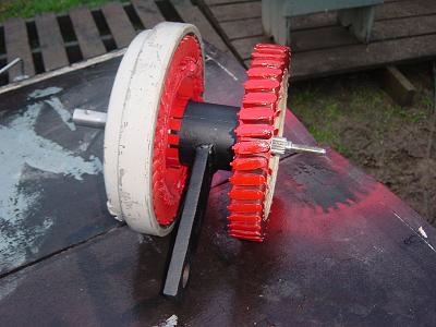

Now a motor.
I know i am going over old ground but canot bring myself to buy chinese yet...

Posted: 04:27pm 21 Jul 2010
Shawn
The F&P is a proven performer. Keep up the good work. Give your self plenty of clearence between the blades and mast.
Looking forward to your progress.

Thanks bob / jim mill is up here is a shot of clerance I may have got carried away and lose power but once bitten buy tower contact twice shy.
See the crows nest tower dos not hinge yet.

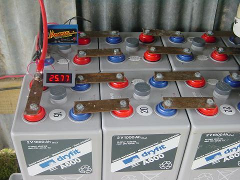

And my bank 24volt

Nice setup, perhaps roll off a bit of that tilt 1' should be heaps with those blades.

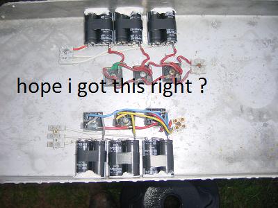

I couldnt be bothered working out if your cap doubler is good but looks about right.

Posted: 12:19pm 22 Jul 2010
Caps are 330uf 400v two for each phase motors at the moment are 100 in delta and
80 2X7C star.
Have noticed one cuts in early not sure which but stalls blades am going to change the 80 to delta and hope I get the right one.
The best figures so far is when I disconected one stator let it spin up a bit then reconected it it held for about 10 seconds at 18 amps 26 volt was furling though.

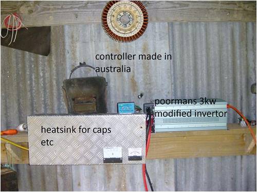

and the switch could not carry
the current hope you like the mods was a little at the time.

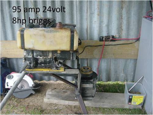

Posted: 12:38pm 22 Jul 2010
Hi Shawn
I have one of "those", and I have to say its been a real blessing at times
Not only good for charing a low battery bank, its also handy for starting a car with a flat battery.
Good pics.

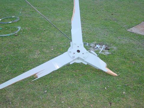

this is what I could do without help
Posted: 02:47pm 22 Jul 2010
Hmmm, is that a current ..whoops! or an old Whoops, you have posted above.
Either way it looks like a sad moment.
Its a bit hard to tell in the photo, but it looks as if the clamps on the guy wires are upside down to, there is an old saying with using cable clamps that should be remembered............. "Never saddle a dead horse"......the saddle should be on the live line and not on the tail end side of the cable.
Pete.Edited by Downwind 2010-07-24

thanks pete did not know which way to put them so put two on one up and one down.
Posted: 06:47am 23 Jul 2010
By saying the saddle it reffers to the metal bit the U bolt goes through, and the U bolt being the girth of the saddle that goes around the belly.
It may not be huge concern in this application but its still worth remembering for future installations.
Pete.

Posts: 262
Posted: 05:01pm 31 Jul 2010
Shaw
I like the distance you have between your blades and mast.
Once bitten twice shy so true.
Your mill is awesome, nice job.
