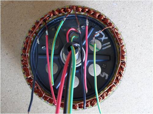

I then pulled it apart and found the star point and reconfigured it into delta , put some 2.5mm wire to the stator instead of the piddley 1.5 and wacked it back in the lathe . The difference was a eye opener for 12v and 24v especially . Torque was almost 1/2 at the same output in 12v @ 350rpm @ 550w with a lot higher cut-in, but in 24v for a lower torque @ 550 Rpm it was punching out 1065W and my lathe motor could not go to the next level .
Pic of Modified stator , drilling has to be enlarged a bit to fit 3 x 2.5mm
However the draw back is the high cut-in Rpms of 330 in 24V, which makes it an ideal canidate for the Cap/dblr to take care of the low wind power

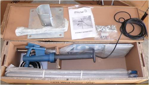

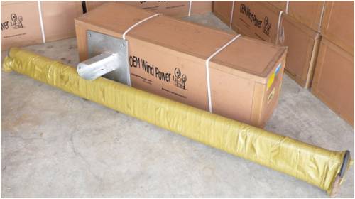

The kits that I have are the very first models to be produced and I have found quite a few areas that need tweeking , but on the other hand it is a very sturdy little unit with some very good points and with a few mods can be a 1kW mill with good all round performance for the price ,( The kit price and more pics/info is in the For Sale section ) it also comes with a 6m mast that is not a piece of junk. I can't match its performance or cost with my F&P duals and will not be making any more .
Kit and the tower in packing .

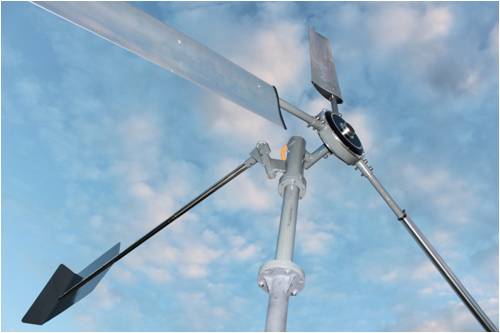

I have one up and flying on one of my masts with a logger to monitor performance and it went up at first straight ot of the box , as you can see from the pics it has the Aluminium GE222 airfoil blades on full length steel tubes @ 2.4m Dia , I had fitted a shorting switch first up because these do stop when you short them , I went out for a couple of hrs and of course the wind started and I got a call from the wife to say the mill is shaking the hell out the tower , she threw the switch and it stoped .
Straight out of the Box .

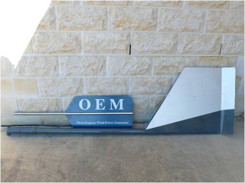

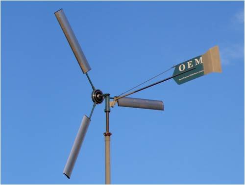

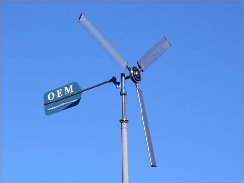

This is the origional tail size against the tail I put on the F&P Duals .
This One I have now done all the Mods to .
The Pic below is one that Forum member Amac has purchased, I have done all the mods to it and is on the way to him at present, he lives in a high wind zone and is setting up logging as well , he will be doing his own thread on how it all goes .

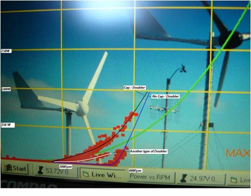

This Pic shows the difference a Cap/Doubler makes on " Gordons Windmill Analyzer" , this is a great tool to use when comparing changes to performance .
With all the changes it is now producing good power in low wind , all the readings in the pic above are in wind below 15-20 klm and it starts producing in under 10 klm .
