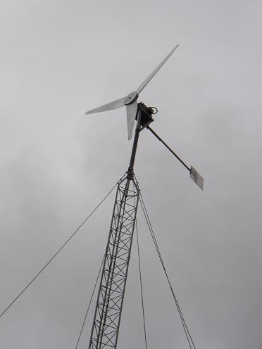

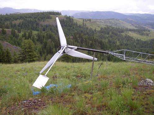

I made it up to the cabin last week
and mounted the new blades on the
existing motor.
The winds came with a front that went through.
This isn't the motor I made the blades for but
had to try them out on the motor I have had in
use for over 10 years before changing to an un-
tested motor.
With the larger rotor it started in the lite
breezes like I was looking for. But was furling
at around 25 amps. So I have to make the tail
heavier to use on this motor.
I want to see how the new motor will work so I'm
going to leave the tail lite for now and just
swap the motors.
Bye the way the 6'rotor and motor combo worked
way beyond my expectations on my test stand.
I think I got them matched nicely. I was seeing
25 amps out of it and it's only 8 feet off the ground.

Here it is up in the air.
I wish I would have taken
more pictures it got really
nice so I went site seeing
more than any working.
97fishmt
Joined: 19/04/2010
Posts: 77
Posted: 03:44am 10 Jul 2010
OK Steven one more
I'm still looking for the gold
