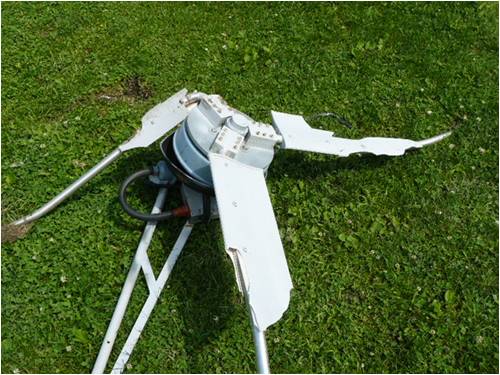

I get home and start putting together what the hell went wrong.

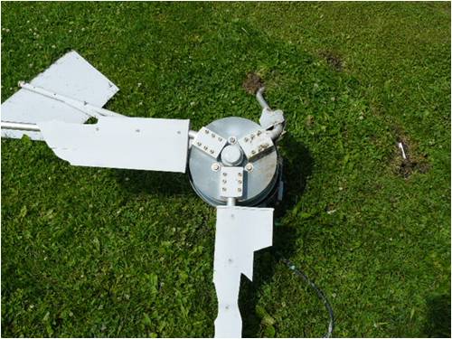

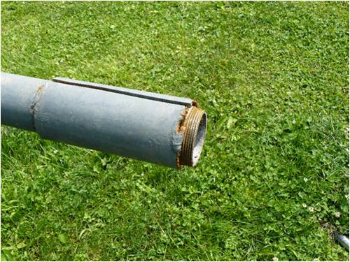

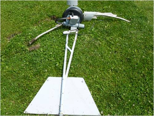

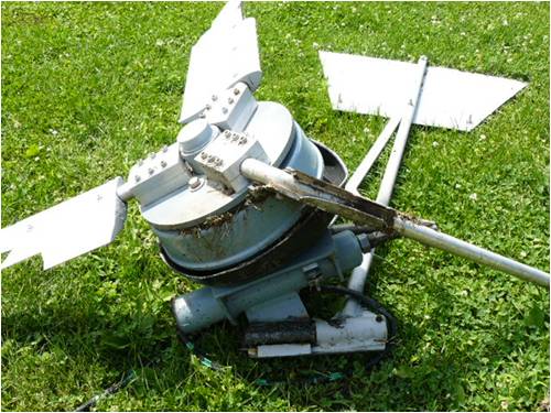

The mill WAS up 47 feet or 14 meters.

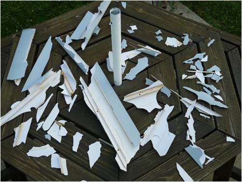

I had a debris field of about a million bits and pieces of broken PVC that was only east of the tower about 150 to 175 feet in distance.
The mill hit the ground (grass, lawn) about 25 feet south of the tower.
The misses and the neighbor both confirm that the mill was stopped and or barely spinning before the storm hit full force.
Question is how do you get so many small pieces of PVC spread out so far from the tower and only in one direction?

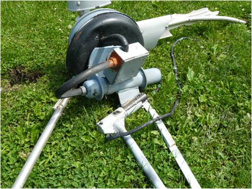

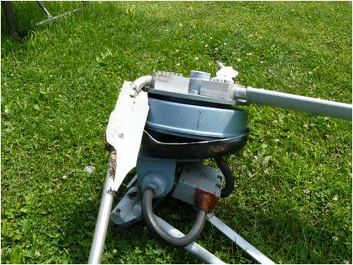

Amazingly the tail, alternator, yaw assembly, blade mounting hub are intact.

looks like YAW box failure, Possibly vibration induced metal fatigue. I have seen a similar PVC confetti blade scene, with PVC blades only a few days old.
This is a dual rotor AxFx mill ???
Is a shame to find a mill this way. You will get it rebuilt I am sure.

30m/s is pumping!
This is the F&P so at those windspeeds there would have been no stopping it
(I cant remember if you put brakes on it)
That said, a real shame.
Good news is Phill has a wee ripper for peanuts send him a PM.
They haven't been released to market yet but for you, i'm sure it will go in the mail tomorrow.
Good to see what survived (lots) so a new set of twirlers and she's away again.
Chin up bud, loooks to me like it happens to the best of them

Is this the F&P you made similar to mine. My F&P ran away even when electrically braked in high winds, 100kph+. I don't have this alternator any more, as I rebuilt the electricals with a Dual AxFx inside the brake drum style housing. No trouble in high winds now.
It is probable that your mill did get away and the forces on the mill head ripped the unit from the pole.

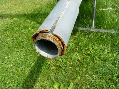

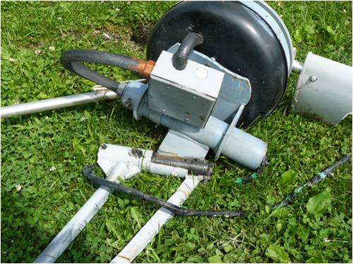

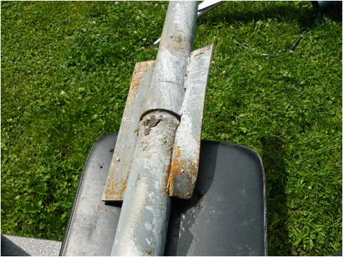

After much thought and some investigation work this is what I believe happened.
The mill ran away with the very high winds, the brakes just weren’t strong enough to keep it at safe RPM. The blades spinning at God only knows RPM bowed enough to smack the mast. I would like to believe that she would have survived the heavy winds if not for blade contact. The photo with the mast on the bench (9th photo from the top) showing where I made an earlier splint repair of the coupling shows the contact area. You can see the (right)metal splint is bent at the bottom right and the entire area has the white markings of PVC. The last photo shows the cut in the solid aluminum rod where she hit the metal splint. I do believe that the energy released from the hit was absorbed by the lower mast mount area and she came down. I am happy to say that the alternator, hub plate, rod mounts and yaw came out in good condition. I got lucky with the tail still intact.
One cannot proceed with repairs and up grades if one does not know what went wrong.
1. First and foremost up grade braking to a system that will, with out a doubt stop it no matter what.
2. Lack of clearance blades to mast.
3. Underestimated the amount of blade flex.
4. The mill, and mast should have NEVER came down regardless of winds or blade contact, mast up grades are in order.
I know I can have her up and flying again soon but until I get a firm grip on a full stop mode she will stay on the ground, hummm that could take awhile.

Sorry to see this PVC confetti. Have a stiff drink and a cry, we all joined in. I read the F&P mill because of its reactance cannot be locked electrically any more once a run-away has been noticed. Did it furl OK?

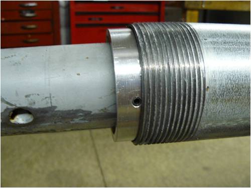

I know some windmill fans like wooded blades but I prefer the Alum blades. Phill was kind enough to send me a new set of Alum blades. When the angle of attack is set correctly these blades are very efficient and quiet. I can actually see when the lift affect kicks in, as a sudden increase in RPM can be observed.
After flying a single stator 60 series F&P with neo magnets I feel strongly that this blade set can easily apply more than enough torque to over power this alternator. Any one who has built and flown a windmill for any length of time has watched as storms have moved in and tried to rip it off its perch. (Not Fun) After seeing mother natures furry it become clear that being able to control or totally stop it from spinning is VERY important. In an attempt to increase RPM and lower, the torque I have decided to decrease the swept area from 8’4” feet/ 2.5 meters to 7’3” feet/ 2.3 meters. So far this mod seems to have worked well.

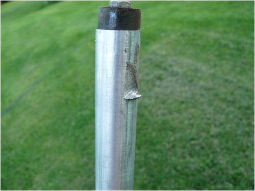

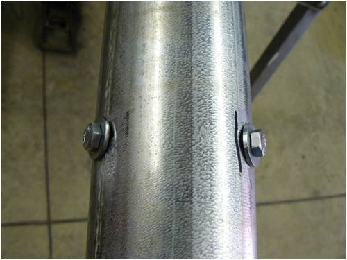

I increased the clearance from blade to mast by simply lengthening the top and bottom steel plates of the yaw assembly. I also increased the blade clearance by increasing the blade angle by having the top plate slightly shorter then bottom plate.
Having the blades strike the mast is one thing but having the mill hit the deck is unacceptable. I have ground mounted PV and solar thermo panels that could have been damaged by the mill.

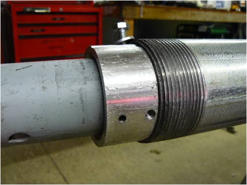

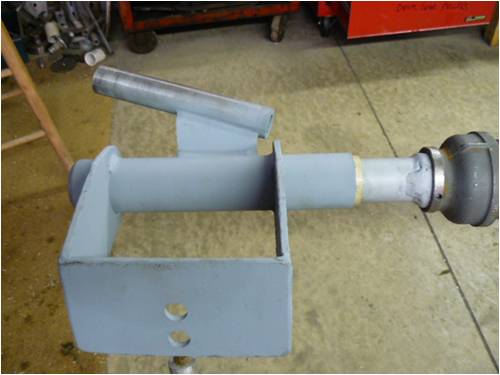

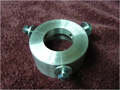

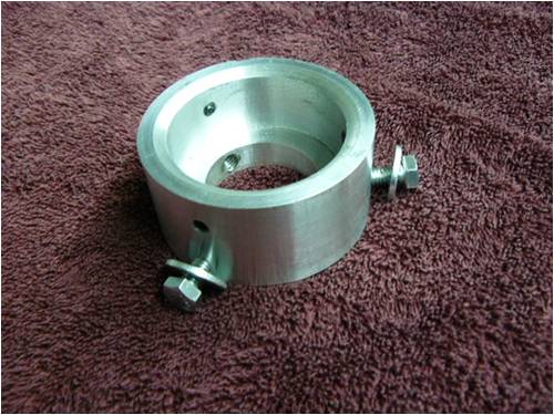

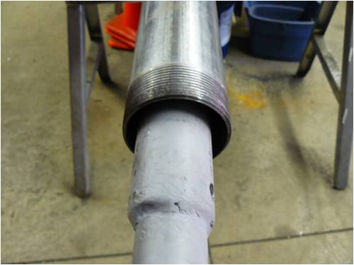

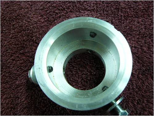

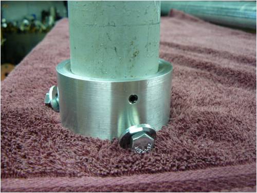

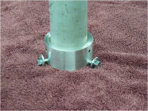

I still wanted to use my original Hugh Piggot pipe over pipe design yaw assembly which used a section of 5’ long 2” OD schedule 40 water pipe that was 5 feet long this arrangement did not have enough rigidity or strength.
Using Alum I machined an adopter bushing so the 2” could be mounted in side a section of 3 ½” IMC electric conduit this bushing is used to secure the lower or bottom end of the 2” pipe. The 2” pipe extends into the 3 ½” IMC conduit pipe approximately 2’. The mill still yaws on a section of 2” pipe but it only protrudes out of the top of the 3 1/2 IMC conduit approximately 18”. It is much stronger and has past some testing in very high winds so far.

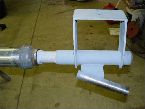

Ok on to the tail and side furling stuff. I know that the tail did not furl as planned so I replaced the original ¾ pipe with lighter square steel tubing.
I also lighten and shorten the lower support strut. Sorry no photos.
