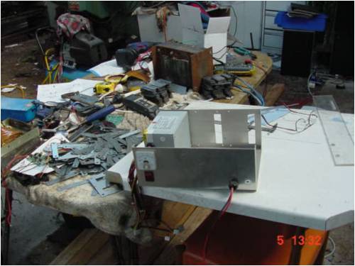

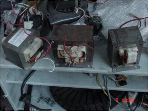

like this:
and this:

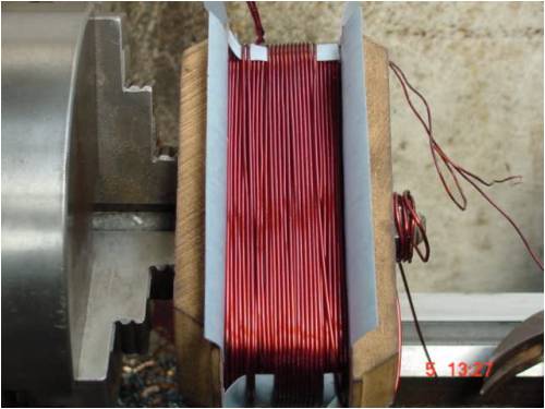

and using 2 lots of plates for a 1.5kw unit..... like this
And here we are winding the primary for that big one. .... it's 1.8mm wire.
Those microwave transformers are the best thing I have come across for good laminates. Their original primary is no good for 240v operation, as it is designed for ferro resonance application (hence the shunt in between the windings). It is designed to run over saturated.... which translates to HOT.
So the windings are only good for spare wire. But the plates are great, and a lot of them use the same size stampings, so you can design your core for whatever cross section you want..... just keep adding plates until you get the square inches that you need to fit the windings in the window.
Strangely, for laminates that are welded together, the eddy currents are not too bad, although I like to separate them, and assemble them in the traditional manner. (the mess in the picture above)
The only exception to this is making low impedance transformers for electric fencing. There I just cut the transformers open at the weld, wind the new windings, and weld them back up. One 40 microsecond pulse per second or so, is not a duty cycle as far as I'm concerned, and they will run fully saturated in this application ..... so niceness is out..... I also use the secondary winding as a source of wire for winding the secondaries of the multivibrator transformer (ferrite core) that supplies the 700v to the primary of the main transformer in this instance
Yes, it will take 3 transformers for a 3 phase unit...

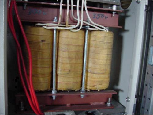

Here is the one off the AWP system.
................oztules
