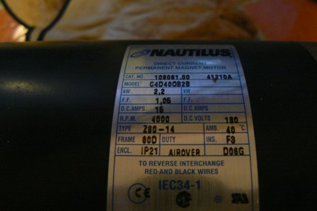

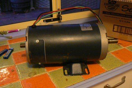

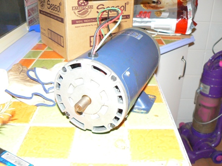

I scored this motor on Ebay, thinking it would be good for my new project:
It creates 6.2 volts when turned by hand.....great!! It has 2 shafts, the short shaft is 5/8" in diameter, and the longer shaft is 20mm Diameter, so I plan on getting a 5/8th Arbor to mount the hub on.
BUT when I put my multimeter on AMPS, it becomes REALLY REALLY hard to turn by hand, although it does produce 1.32Amps by hand. Is this normal to become so hard to turn? I have been in contact with Windy Nation and they recommend I use their 5 Blade Hyper Spin System, which I was looking at anyway, but I fear I will need a hurricane to get the blades spinning
What are your thoughts on this please? (Be gentle on me tho )

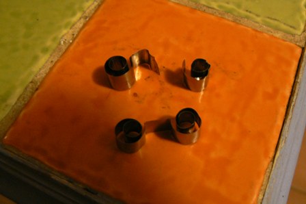

BUT the person I bought it off put the small metal coil things that hold pressure on the brushes in the wrong way, so when I pulled them out, one came out in 2 parts.....bummer!
Does anyone have any ideas as to where to get these things from? or what is a suitable replacement?

Posted: 02:31pm 20 Jun 2010
Can you post a photo of the "little metal coil thing" thats broken.

Posted: 02:46pm 20 Jun 2010

Here you go Pete:
The top one is the broken one, the bottom one is how it should look.

Posted: 04:29pm 20 Jun 2010
Gee never seen any thing quite like that.
I had wondered if you could use the spring retainer from a starter motor but havent seen any like those.
Send the seller a email and say you had trouble with the motor and on inspection you found a broken brush retainer clip.
Under ebay rules he should replace it or send a replacement part.
If you dont ask in this world you dont get.
Worth the cost of an email i would think.
sorry cant offer any surgestions of what to replace it with.

The stub axle and bearings works well, the brush springs can be made from some modelers spring wire available from aircraft model shops, you make a pin jig and wrap several turns around the pin to duplicate the shape and size of the original, I am assuming the brushes have a pig tail wire attached, if not you will have to make one by soldering pig tail wire to a piece of copper and place it under the spring in good contact with the top of the brush, this is necessary as the spring wire will heat and soften if you run much current through it.

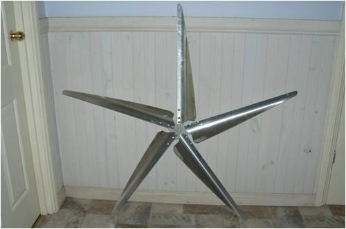

Posted: 02:15am 19 Jul 2010

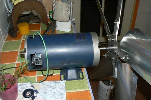

OK, here's a pic of my blades from Windy Nation:
I also got an arbor to mount the blades onto the motor shaft, fits like a glove.

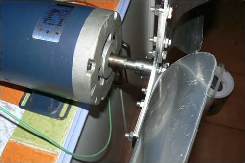

The problem I now have, is that I don't have access to welding gear, and the motor has a stand spot welded to the outer frame, as shown in the picture below, But the weight is off centre would it be worth removing the stand somehow and attaching the casing directly to some sort of mount or just leave it as it is?
The smaller shaft on the left is the side the blades go on, but the stand is off centre, would this matter? As long as the head of the mill is level horizontally, it should have no problems in turning into the wind, right?
Next problem is mounting it onto a pole. What is the best set-up for a bearing mounted onto a pole?
Thanks Guys.
Paul

Posted: 02:28am 19 Jul 2010
Hi Paul , the stand will be ok left where it is ,I've a couple of those motors , that stand saves you lots of welding work which ,by the way, you would have to remove most of the "innagds" before welding. mounting on a pole ,, try a flat plate ,say 1/4 inch thick mounted on a pipe..put a collar on the pipe and it then slides into the mast pipe and revolves ,easy, feed you wiring down the inner pipe and untwist every few weeks ,plenty of info ,just read about it on this forum.
Bruce
