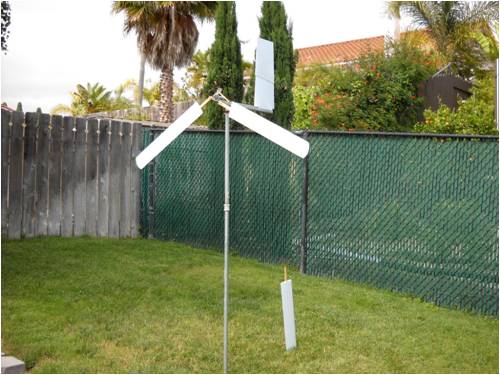

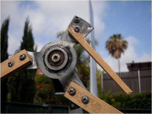

Oops!
You gotta know this puppy was haulin' balls when things let go!
You know . . . I had every good intention of encasing these blade
stand-offs in an aluminum channel this weekend. I just wasn't fast
enough, eh?
I'm reasonably sure this is why I call this little tower my "test" stand. I'm also reasonably glad I wasn't standing there watching; I'd likely have had to go change my britches!
Now if this had been up in the air 30 or 40 feet, I'd be searching the neighbors' yards for the blade. These blades weigh in at only 4.1 ounces, so I'm pretty sure it would have sailed quite a ways had it not hit the grass as fast and as hard as it did.
That's what it's all about, right? Gotta test stuff to make sure it's gonna work; back to the drawing board!
. . . . . Mac

Mac
When in doubt over build.
The wind loves to destroy anything it can.
Just my thoughts but your components look a bit on the lite side.
Looking forward to your up grades.

The funny thing is, I wasn't going to leave this thing on the stand for more than a day. I was just testing how well the Coroflute blades flew and was going to take things down when I got distracted and just plain forgot. Mom (Mother Nature) reminded me today when I came in from having muscled a water heater into place all morning; ready to relax a bit -- NOT!
I figured the wood shanks would have pulled through at the holes, since one on each blade was within only about 1/4" from the end. In all likelihood, that's where the crack started and centripetal force took care of all the little details! I'm sure yawing had some input as well.
I'll be constructing a set of three high high aspect-ratio blades tomorrow and I'll throw them on the same stand to see 'if' or hopefully 'how much better' they fly. I read a great Link oztules sent me about Mr. Jacobs (Jacobs Wind Electric, circa 1920's - 1950's) and he said long, narrowing blades were the ticket.
When I say "high aspect-ratio" all I really mean is they will taper and get narrower as the blade root approaches the tip. I don't want anyone to get the idea I've actually figured anything out mathematically. Heck, no; I'm a trial-and-error guy through and through. If it works, I leave it be; if it doesn't, I wrench on it a bit more. I'll be wrenching on blades all this weekend, be sure of that!
I'm also going to try to fit together a single-bladed mill with a pitching device to throw into another thread here somewhere. I've built those kind before and they go scary fast, so I'm hoping to be able to do a youtube video of it before it self-destroys; hide and watch.
. . . . . MacEdited by MacGyver 2010-06-13

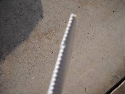

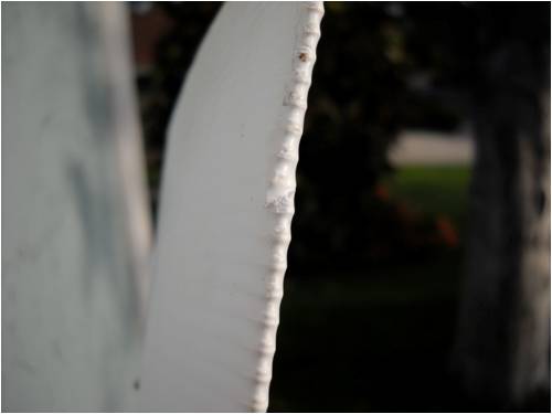

On closer examination of the blade, it appears the spar cracked, letting the blade fly towards the tail and the final blow was caused by a tower strike. Here's the evidence:
See that dent? It wasn't there when I built the thing. This method of
construction I might add makes things nearly bullet proof!
Here's another view of that same dent. This had to sound like a firecracker
when it whacked the test stand; now I kinda wish I had been there!
By the way, in the first picture of this thread, I dug a hole in the grass and stuck the blade in it so I could take a picture. It wasn't going so fast that it dug its own hole. Thought I should make that clear so nobody gets the wrong idea. I found the blade lying on the grass several feet away.
. . . . . Mac

Hi Mac
I know how you feel, I lost a 3 blade 3' "1 Meter" prop, My first one build.
I so happy the way it turned, It hit tower too. But It lasted about an hour.

Are we learning yet!
My blades AKA Phillm aluminium jobs weigh in at best park of 4KG each.
BULLETPROOF!!
build the spars at the very least much much heavier. weight is not the enemy here.

That kind of reminds me of my 8.5 footer that blew up once. I lost the generator in it and had a runaway in 40+ mph wind. The blades held - got PowerMax 085's on it - but the magnets were a different story. The mags were scattered halfway across the county. Never did find four of them. That turbine hit well over 1,000 rpm and I just retreated to a safe distance and watched once I realized I didn't even have one phase left in it that could be used for braking. When the coils blew and the stator expanded it didn't even attempt to slow it down or lock it up - it just tore all the mags off the rotors.
All due to my furling calcs being a little bogus.
So that's when I invented my vertical hinge tail setup with an adjustable, spring-loaded power limiter. Every turbine since (I got five flying from 8.5' up to two 13 footers), I started pinning my mags to the rotors, using a vertical hinged tail with a spring-loaded power limiter, and put a half-wrap blast shield on the gen so if I get a runaway and it throws mags it directs them to the base of the tower instead of tossing them into the brush in the neighbor's back forty.

I guess that you must have explained this before, somewhere, but what, exactly, is coroflute, and where do you get it, or how do you make it? I have tried to google the name, but all that I can find is corflute, which seems to be a different product.
From what I can see of your blades, they appear to have a series of of bumps along the leading edge. I have a hazy recollection of reading somewhere that whales have similar knobs along the leading edge of their flippers, and this has been found to greatly improves their effectiveness in water.
Is this what the coroflute lumps are for?

its interesting about the bumps along the leading edge...i remember reading that topic as well ... i think the bumps on Macs blades are a by product off bending the coroflute ..the ribs inside the plastic deform a bit and so the bumps come in ?
its used a lot on signage here ...during elections you could gather a load off the stuff as every pole seems to have 2 or 3 pondlife with their their well fed faces adorning it

niall1 is correct about the bumps in the leading edge. They are merely a by-product of bending the stuff. Where the little, square cells bend, some of that material pushes up and out and together they form little bumps. As for adding to the aerodynamics, that's a coin toss, I dunno. One thing's for sure, if a blade were to hit you, it'd likely mash you rather than cut. When I said hese things are "bullet proof" I wasn't kidding. They are smooth, hard, lightweight and very robust.

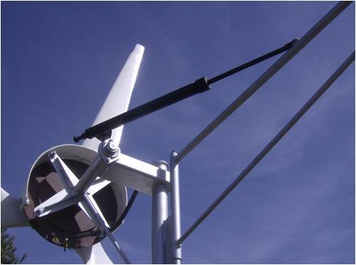

Couple thoughts here, take them for what their worth and realize I'm not being critical, just conversing.
1. I don't think these coro blades have that great of a profile. Understand it may be easy for you to work with but the profile you called 'perfect' in another post was quite lumpy and the trailing edge was extremely thick. Two material thicknesses. You want a TE that comes to a knife edge. This poor aero profile probably explains the lack of performance (rpm) shown in your vids.
2. I don't think these light weight blades will endure the ravages of the wind at all. You call them bullet proof but here we are in a thread where you first set failed pretty quickly.
3. You say they are extremely fast but all your videos show them not spinning or barely spinning. Do you have vids where they are actually cranking away?
4. Putting them under load (i.e. a generator) will only make things worse. If you are having troubles with a free-wheeling turbine then what is to come?
5. About your failure in this post. I noticed that your spar is not in line with the center of your hub. They look angled. As the hub rotates this causes a torque moment where they mount to the hub, causing the spar to split as shown in your picture. Have the spar radiate directly from the rotational axis of the hub and you will eliminate this troublesome moment at the base of your 'shank'where it split.
Just some thoughts. We have traded posts for a while so I assume you won't take this as me being a jerk. Just know you good enough to start hitting you with the 'level 2' questions now.

To answer your 5 thoughts, I must reproduce a quote from the movie Bruce Almighty: "Yes to all." That was from the part where he (Bruce-who had taken God's job for a few days) was faced with answering about a billion prayers (emails) many of which were to have the winning lottery number.
First off, there's virtually no wind where I live. It's here, then it's there; little spurts. Great place for small birds. Not so great for serious windmills. I have a little test stand that I could load up and take down to the coast where there's lots of wind. Maybe I'll do that and take a video there too. I'm having great fun with the videos, ya know! Ain't technology great?
In fact, "fun" is 99.9% of why I do this; I enjoy it whether it works well or not. When something seems to go right I post the results. When things awry, I post those results too. I don't mean to be a pest, but I know I likely am; sorry!
As for the Coroflute blades, I like 'em. I'm going to build them whether they're "perfect" or "bullet-proof" or not. In my opinion, they are. If the rest of the crew wants to build them too, that's cool. If not, I'm okay with that too; no worries.
The fact that the blade spars are not centered on the hub is due to my laziness. I stole the hub off another windmill. When I get the time, I'll build a real hub and clean things up a bit, but for now, I'm happy with what's spinning out in my backyard. If it comes apart, it'll make a dandy story. That's not to say others should follow my lead and I try to make that clear in my postings. In fact, I just posted an "Alert" in that regard, having discovered closing the blade ends encourages rain water to partially fill the blades, throwing them way off balance even having been nearly perfectly static-balanced before letting them fly.
The generator is in the works and if the mill won't turn it, I'll cross that bridge when I get there. For now, I'm just taking things as they come down the pike and not worrying much about anything long range.
