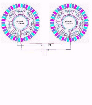

GADGETS
Joined: 10/03/2010
Posts: 8
Posted: 12:29pm 30 May 2010
Hope the image comes throu as this is my first time. If it does would it work with the diods
Charlie
Posted: 02:20pm 30 May 2010
Pic is not real informative, but looks like you have a series diode, in each phase lead from each of the stators. Not sure what you are trying to achieve with this?
I presume that you are hoping to use the star point as a centre tapping point for a 3 phase rectifier, on each stator. This is like a 2 diode arrangement for a centre tapped Xformer with full rectification, but for 3phase.
You may be able to clarrify.
Gordon.
Posted: 02:29pm 30 May 2010
Basically you are trying to reinvent the wheel....Why????
Just use 2 x 3phase rectifiers, 1 for each stator.
Then join the 2 DC positives together and the same for the negatives.
Dont worry about the star point (or neutral as you called it) there is almost no point in using it with 3 phase.
If your method was worth doing than many here would have done it years ago and it would be widely posted to the forum.
Pete.
