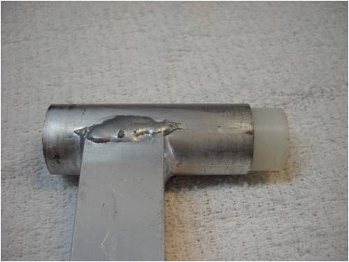

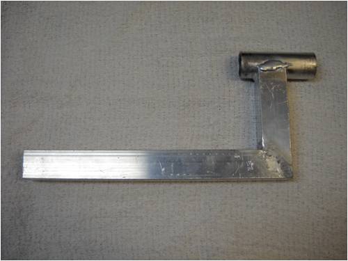

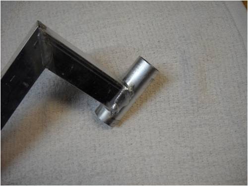

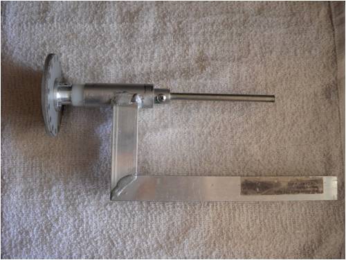

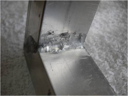

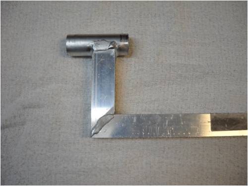

This shows the basic all-aluminum chassis. I've used both square and round T-6 extruded aluminum. The base will be welded (later on) to another round aluminum plate, which will cary it on the mast or tower and act as a pivot, enabling the machine to turn into the wind via a flat tail. The tail as well as the blades will be constructed out of 2mm "Corflute" extruded plastic sign material. More on that when my shipment of Corflute arrives (next week???)
My digital camera does not like tight shots. I apologize for the blurriness, but I wanted to show how nicely the round tubing welds to the flat tubing. This round piece will hold the windmill's main shaft; blades on one end and rotating magnet wheels on the other.
Here's another angle showing those welds. These are basically "butt" welds. I'll explain more about the welding technique just a little farther down this page.
I'm showing this shot to let everyone see that the welding technique does not distort the aluminum tubing on the inside of the weld. This tubing, by the way, is 1/16" thick. That's really, really thin stuff to try and weld without burning the crap out of it. More later.
Here's another view of the entire chassis facing the opposite way. For now, you'll have to visualize with me: The three Corflute blades will be mounted on a hub to allow balancing and easy installation and removal. They will face into the wind. Behind that will be the main bearing, which in this case will be a "bushing". This entire chassis is only about 12-inches long, mind you -- yup, it's just a little fellow. You can make yours any size you want, but I like small stuff. There will be stops on the main shaft each side of the bushing, keeping its fore and aft travel to within less than 1/1000th of an inch. That's what we call a "running fit". It's not tight enough to bind, but won't wander either. Behind that will be a pair of wheels housing several neo-magnets in a circle around the wheels. These will be arranged in a N-S-N pattern and will each barely glide over the surface of a set of copper coils (called the stator) which will be locked to the chassis between the two rotating magnet-carrying wheels. On the rear end of the thing will be a Corflute vertical stabilizer, much the same as seen on the tail of an airplane. It will have a small controlling surface (rudder if you will) to allow me to compensate how far into the wind the thing points, so I can offset the action of the angular momentum created by the spinning mass. I'll cover all that when the time comes.
Okay, I know it's on everyone's mind, so here's the Big Question: How do you weld aluminum without a $3,000.00 heli-arc set-up?

You're absolutely right about weld penetration, but the up side to that is it doesn't distort the material (due to the lower heat range) and any over-the-top stresses could be bolstered using other means like clamps or straps.

I didn't try to break my new toy, but it "feels" pretty tough. Since this is such a small build, I think it should hold up under heavy winds. I plan on making the blades only 18" - 24" (haven't decided yet). A larger machine could use "gusset" welds as well as some straps and bolts if necessary. The welds just make it look cooler, IMO.

Remember, this thing is only about a foot long, so I imagine if I blasted it with my 20-gauge pump, it'd still survive.
I took the "welded" chassis to my nephew's work (he's a certified welder) and he tugged on it harder than I would have liked, but it didn't budge. I think it's pretty strong despite my agreeing with everyone's point of view that it is merely metal-hot-glued together.

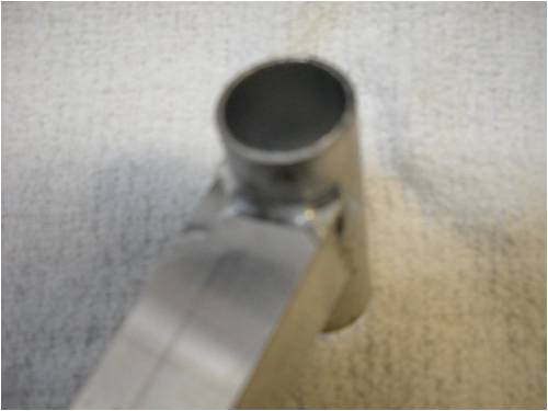

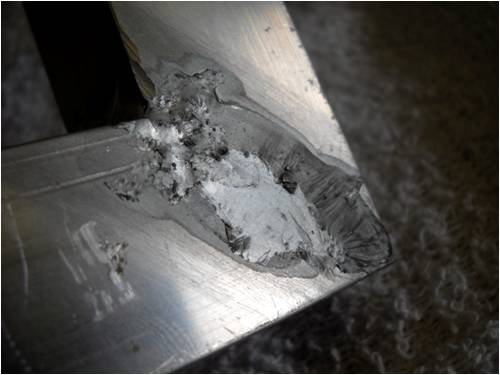

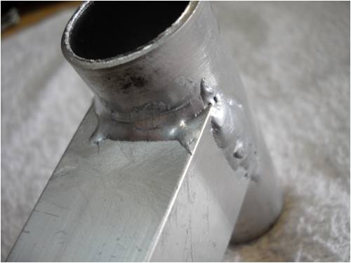

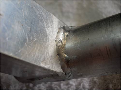

Okay, I took Pete's advice and messed around with my camera until I found that little flower and guess what? It worked:
Here's a clear tight shot of that round-to-square butt joint.
Here it is again from a different angle.
This is that flat-seam butt weld.
And lastly, this shows the 45-degree butt-welded joint where the frame
members join. This is the joint my nephew tugged on so hard, I thought
I'd faint!
Thanks for the advice, Pete.

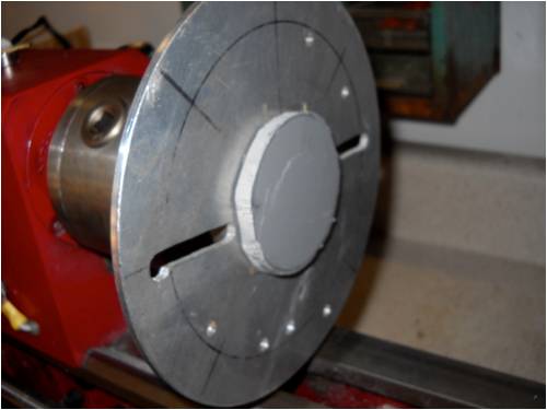

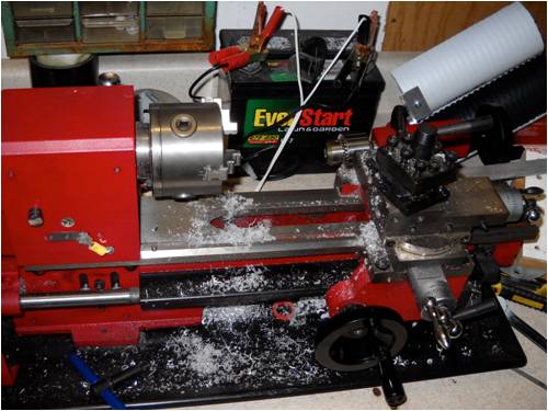

Just to keep things in perspective, this is my lathe and it's run by that
12-volt garden tractor battery sitting to the rear. The reason for all
this "smallness" is I plan on retiring in my travel trailer when the time
comes (soon!).

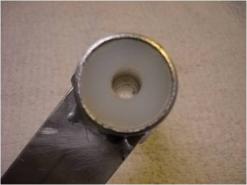

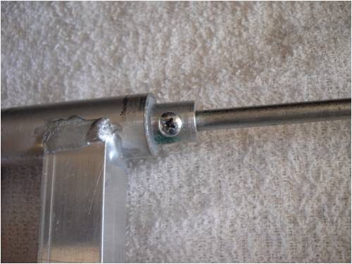

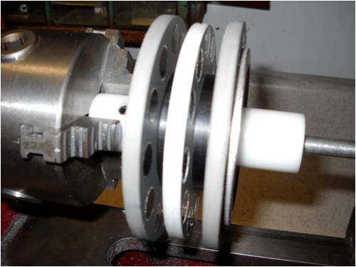

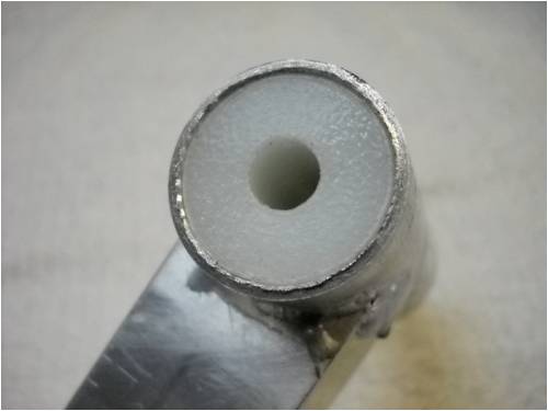

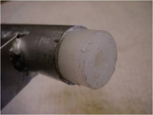

Here's the back end of a HDPE (high-density polyethylene) plug I am
using as a bushing to hold the windmill's shaft. The hole was cut with
a letter "O" drill; the shaft is 5/16" steel. This gives a good running
fit.
Here's the same shot from a different angle.
I cut the bushing with an "interference" fit and jammed it into the
aluminum tubing. There is a tiny shoulder cut on the front to keep
it from traveling under load.
This is the FRONT of the windmill's main bearing (bushing). You'll
likely note I "faced" the rear and not so in the front. This is so I can
test the wearability of the rough HDPE against a thrust bearing. If it
smoothes out from wear, I'll just face it off next time. It is just an
experiment.
Next up will be the main shaft and the hub, which will cary the three
Corflute blades (still waiting on the Corflute shipment!). Stay tuned!

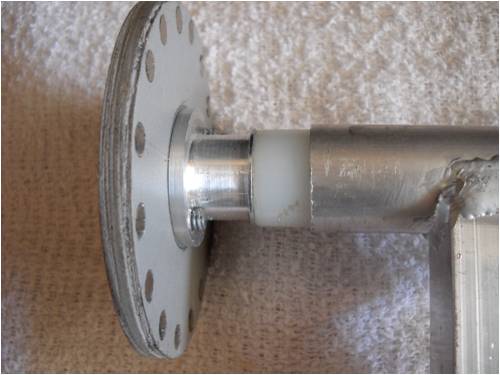

For the time being, I've cannibalized a former build just to use the parts
and not have to make more. This is the basic shaft, with thrust washer
(front) and stop (rear). The shaft is 5/16" steel and I ran it into the
bushing using light machine oil and a high-speed drill. Spins like a top!
In the picture it looks crooked to me too, but it's not.

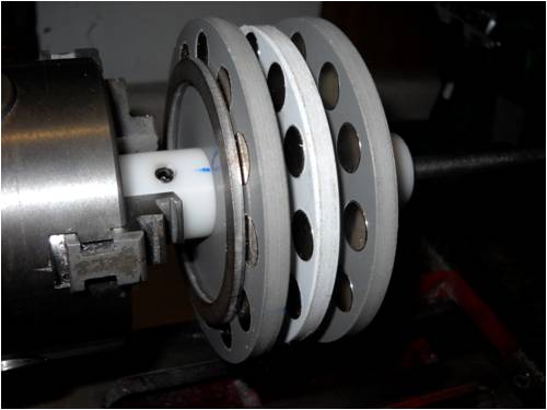

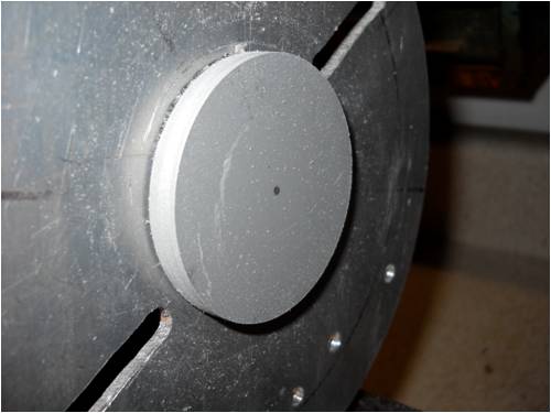

somewhat less-than-successful build (Oz snickers!). The plan is to remove
the wheel containing the neo magnets and replace it with the blade hub,
which will be turned in the next few days. Still awaiting Corflute shipment!
Here's the tail end. I used a 10-24 set screw to anchor the stop to the shaft.
I will turn two more plate-hubs similar to the one on the front end; each
will hold one set of opposing neo magnets on either side of the stator.
Stay tuned!

Hey Mac,
I just noticed in the first pic of your last post that your rotor is inclined about 3 degrees, presumable to prevent a tower strike. Come clean, was that planned or a mis-alignment during fab? Am I the only one that has welded something crooked but had it actually end up helping in the end?
Perry
MacGyver
Joined: 12/05/2009
Posts: 1330
Posted: 11:04pm 21 May 2010
Perry
Nope; it's actually straight. When I snapped the picture, the angle of the lens made it look crooked. I measured everything as I built it and afterwards as well, so I know it's straight. I put a little disclaimer to that effect in the picture caption, by the way!
Edit: I think I figured out why it looks crooked: The wheel holding the magnets has lifted the whole shebang off the table a bit and I took the shot straight down from above. This would put the shaft portion of things on a bit of a tilt, thus the illusion that it's crooked. Sounds good to me!
Even if it were a little crooked, the way this thing is going to be built, it wouldn't matter. The critical part is that each magnet array runs parallel to the other and to the stator. If that turns out to be on a bit of an angle, no worries.
As far as the blades striking the tower, I don't think that will happen (I suppose everyone says that though, eh?) because I'm using symmetrical-section blades and a positive pitch of between 15 and 25 degrees (I think). Until I actually jam things together, I won't know the final pitch, but when I figure it out, I'll post it.
The only tower strike I've ever experienced was using aluminum Clark-Y blades, which had positive lift. That was a doosey of a strike, by the way!
. . . . . Mac Edited by MacGyver 2010-05-23
