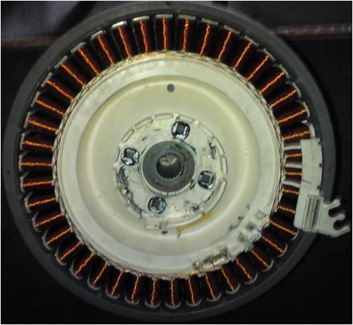

Hey guys I've just picked up a smart drive motor and wanted to know if anyone could identify it for me by this picture?
thanks guys!Edited by Sk8er_Square 2010-05-15

That would be a 42 pole 60 series, the most common type found these days. It looks to be in good condition.

I have also noticed that the 60 series use a darker coloured enamel on the wire, similar to the 100 series. The 80series is more yellow.

They also stand out because of their messy windings compared to 80s & 100s

It just goes to show some of you have had just to much to do with F&P stators, that you can tell from a blury picture.
It might be worth mensioning that the series 60 relates to around 0.6mm dia. wire used for the coil windings, and hence S80 = 0.8mm wire and S100 = 1.0mm wire.
This is the method of refference to each stator or series.

With my new glasses I could see right away this was a 60 series F&P. I should mention that I own one 80S, one 60S and have never seen a 100S
