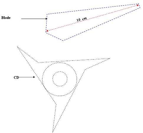

I will clarifire what Gaby needs for a blade design.
The max dia is 250mm (10") it needs to be mounted onto a CD and the hole must not be modified but the rest can.

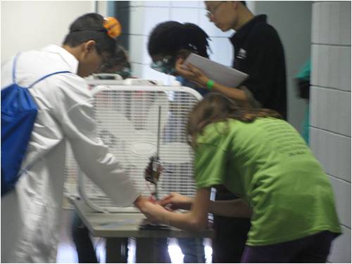

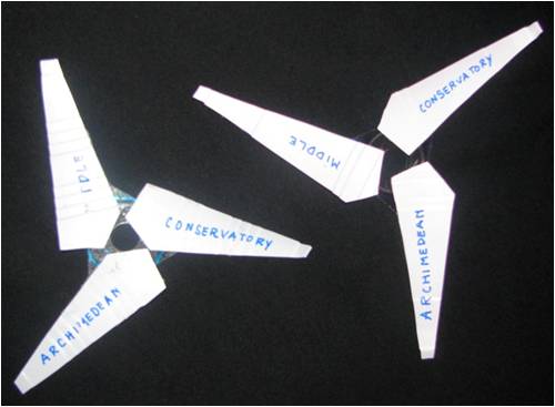

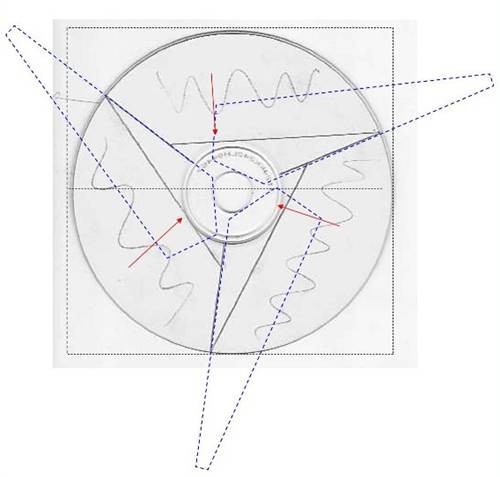

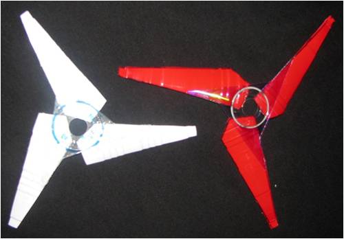

Here you have some pictures of my minimill, to have a better idea as Pete said.
Turbulence is my problem ... When the windmill raise a 1000 mV the blades start to fold. I already tried with some plastic materials but these materials increase the weight and reduce the velocity.

Try smearing cheap superglue on both sides of the paper (1 side at a time and allow for drying) of the area that requires the extra rigidity. But take care as superglue produces dangerous fumes and plastic gloves would be handy as well for skin protection. Experiment first to see how it works for you.
