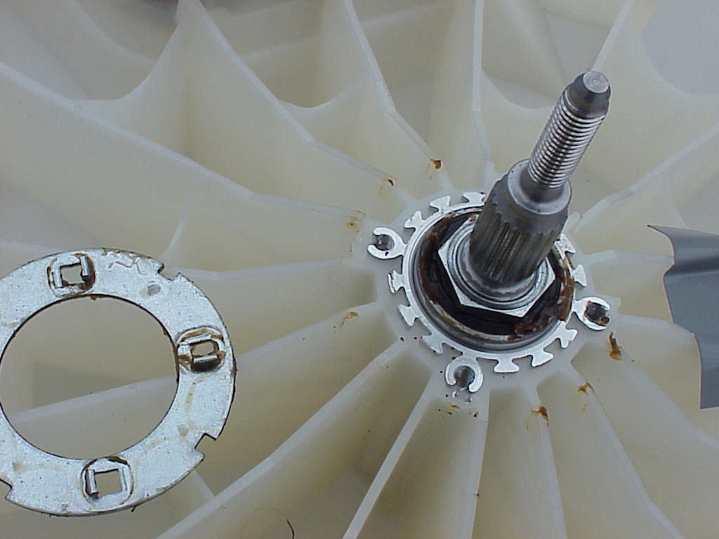

On the end of the shaft the hub and stator cam off, there is a big nut. With the machine up side down, after you have removed the hub ( undo the plastic nut ) and the stator ( 4 bolts ), you should have the shaft looking at you. There is a large nut on the shaft that needs to be aken off. They can be tight, you need to grab the shaft with a pair of multigrips and use a large shifter on the nut. Once off, then tap the shaft down and it should fall throught.
There are no reverse threads to worry about.

Just came back in to say "I went back with the mindset that it HAD to be simple" and found just that! Was about to post some pics!

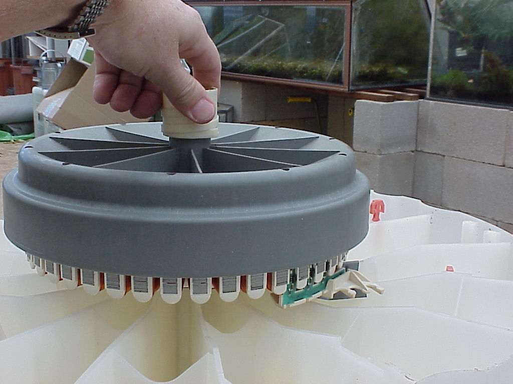

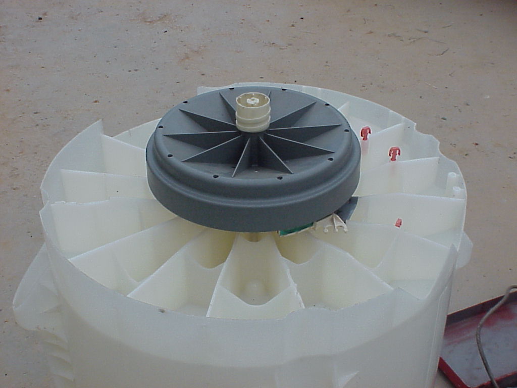

For anyone else whos in the same boat (and I suppose, for historical reference)...
Looking at the complete assembly from underneath. The transport locking ring (pale thing on the end of the shaft) can be turned anticlockwise while holding the motor rotor steady.
As you turn it, the rotor comes off the shaft, exposing more of the coils. Eventually it is fully undone and can be lifted off.

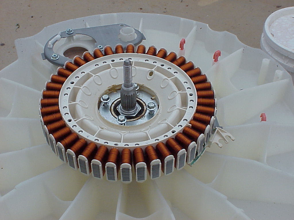

The 4 bolts can be undone (I used a 3/8" socket, but it's probably some mongrel metric size!)

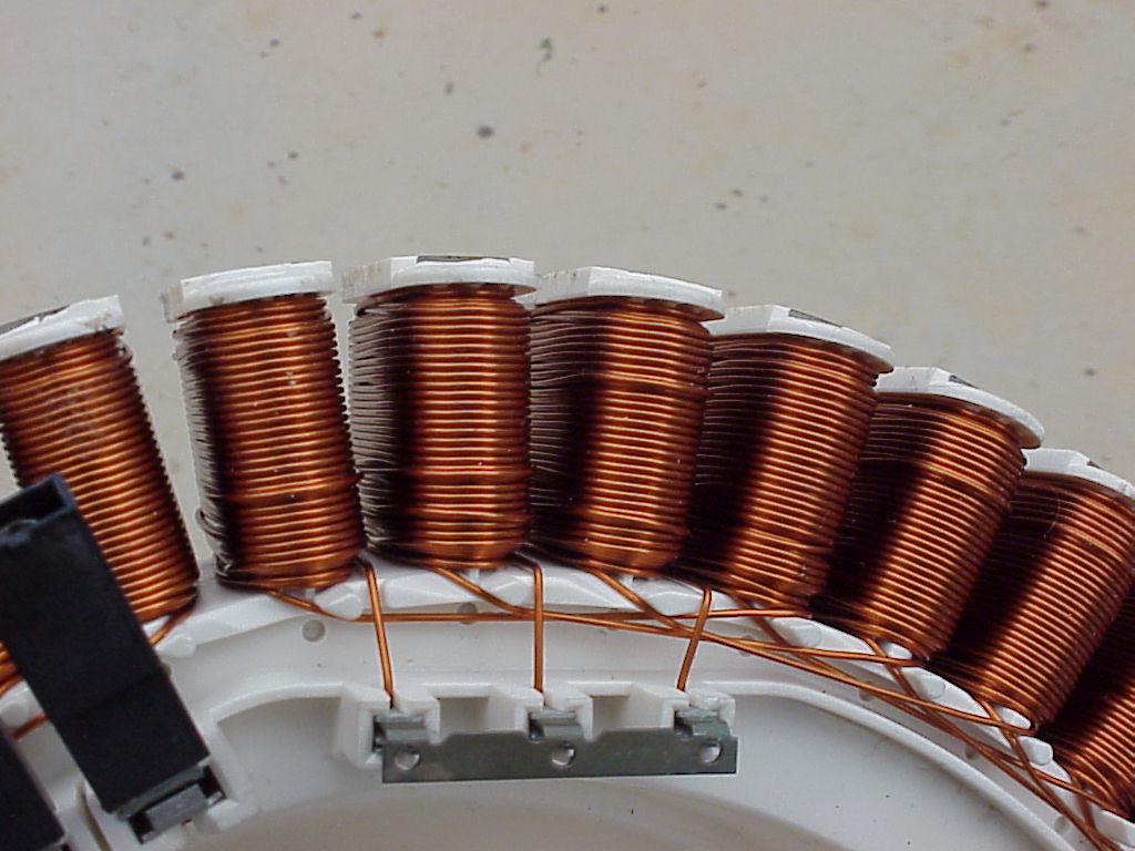

(Can anyone identify if this is a 60, 80 or 100 from the closeup of the windings?)

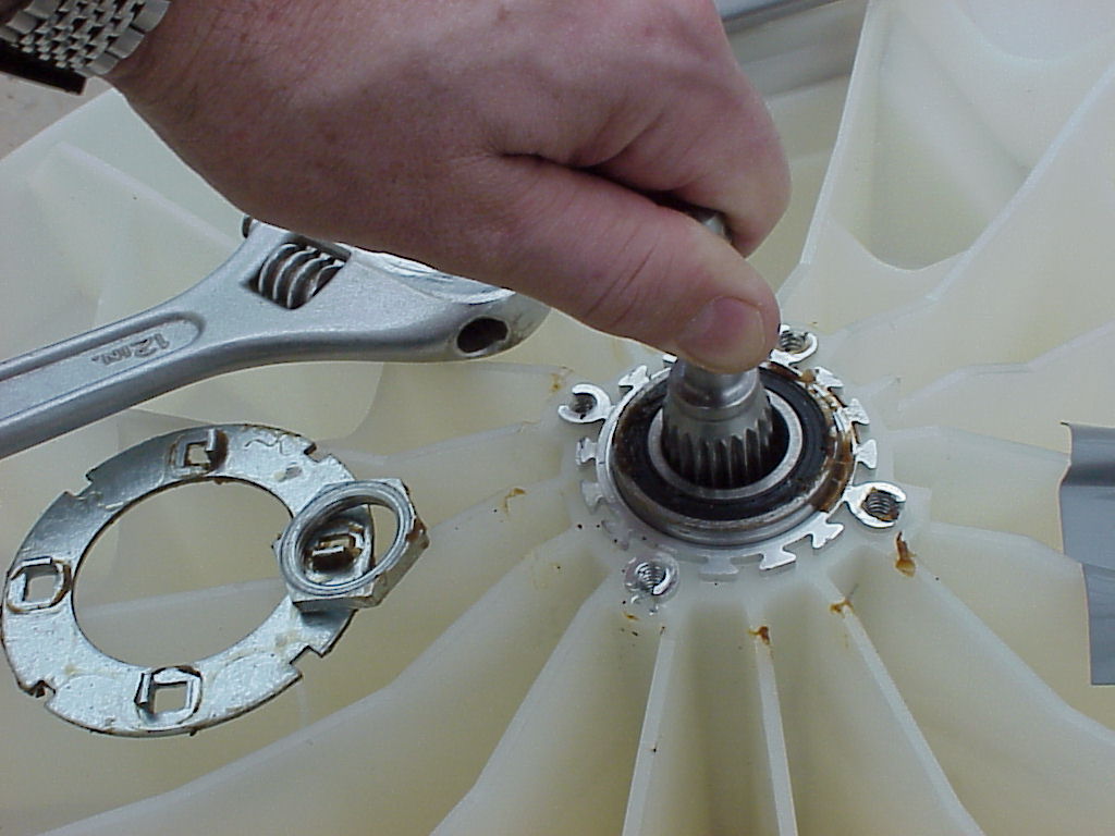

With the bolts undone and the coil assembly removed, the shaft and bearing housing are visible. Hold the shaft with multigrips or vicegrips (use some brass or copper shim or similar to avoid damaging the shaft) and undo the large nut with a large shifter. Don't smack your knuckles into the spanner like I did when it finally lets go).
Then ease the shaft down, through and out.

Thats a 80 series Ross, a good all rounder
