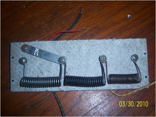

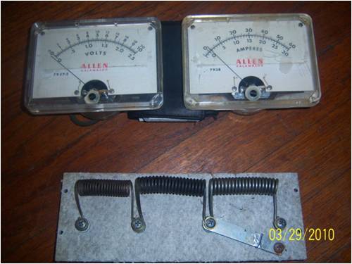

i found one old amp and volt meter dc both and a coil like spring i thing is lake a resistor with different size's look like the one come from a heater this come inside with the volt and amp meters ...i will take photos ...by the way thank you for all the help from each of you.
Posted: 04:11pm 30 Mar 2010
I would think the coil like spring is a shunt resistor for the amp meter.
The power is passed through the shunt and the amp meter is connected across the shunt.
This allows for mV meters to work as a amp meters with all the current flowing through the shunt and not the meter.
The photo should tell us.
Pete.

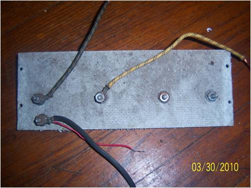

ok this is the photos
Posted: 10:05pm 30 Mar 2010
That looks suspiciously like the asbestos you should not be messing with. take care when you play with old stuff.
Gordon.
Greenbelt
Joined: 11/01/2009
Posts: 566
Posted: 11:13pm 30 Mar 2010
DTV004,
This appears to be a resistor or a old system to regulate voltage to the fields of a large motor controlled by a rheostat (not in photo) just guessing . it appears that the lower scale on the ammeter has been the one in use at the time.
Notice the 2 coils look burned The third one does not and the metal jumper is tapped between coil 2 and 3. The meters in the photo may not have a shunt inside , If not they will be destroyed when hooked to a battery.
I suggest you find an ammeter in an auto parts store or salvage yard, customized instrument panels, Some have amp gauges calibrated in 5 ampere divisions.
this will get rid of the old hardware and guessing how to hook it up.
EDIT; Changed "shunt resistor" to "resistor" and "shunt resistor" ro "shunt"Edited by Greenbelt 2010-04-03

yes is from old battery charger....ok i will do.Edited by DTV004 2010-04-01
