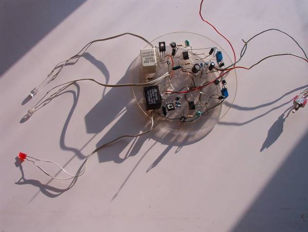

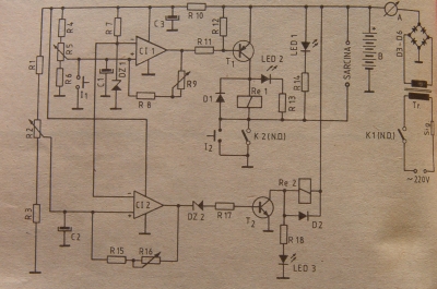

This is a charge controller he built, the circuit....
and this is his finished layout, ready to be put in its case. I can forward the component values and translation if anyone wants it. We call this way of making circuit boards "bread boarding", its very fast and great for one off designs....

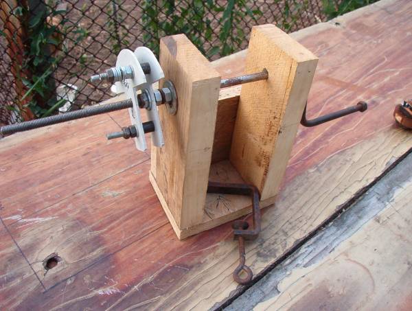

A coil winder....

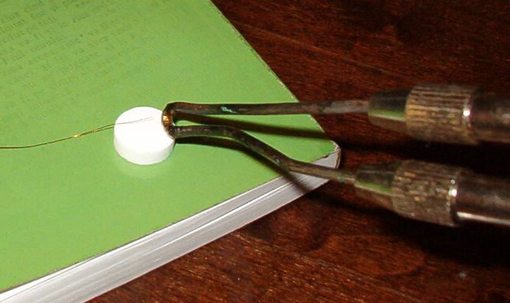

Now for the Asprin tip. To solder enameled wire, we would first scrape off the enamel coating with a knife or sandpaper, or use a small blow tourch to burn off the coating before soldering. Vasi uses a asprin! I tried this, and it works fantastic. Put a asprin tablet on the bench, then place the enameled wire on top. Hold the wire down with your soldering iron, after a second or two, apply a little solder. The asprin starts to melt, cleans off the enamel and tins the wire in one go. Only takes a couple of seconds for a perfectly tined wire. It does smell a bit, dont know if the fumes are toxic, but the results are worth it. You can use the same tablet several times....
I wont be using sand paper ever again!

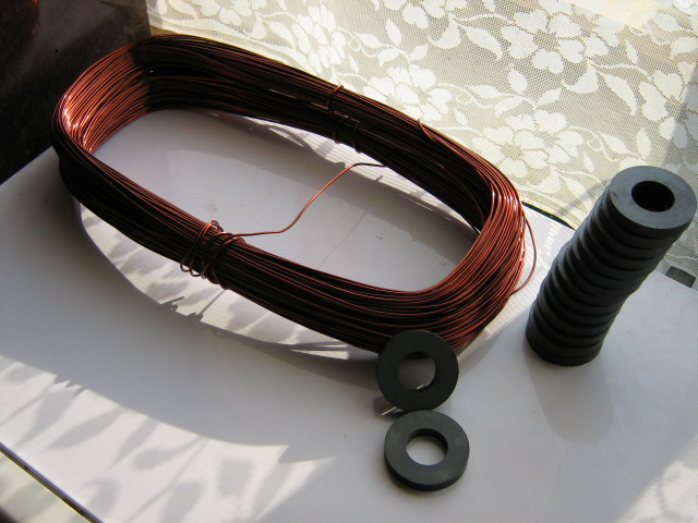

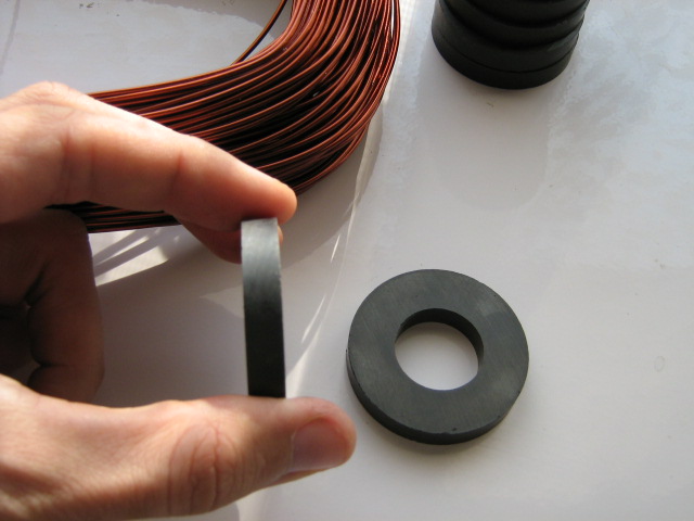

I intend to use this for a double rotor axial alternator. The wire is 1.5 mm diameter and weight=2 kg (i hope it is sufficient). I have 16 ferrite magnets.
        * D=45mm
        * h=7.5mm
        * d=22mm
