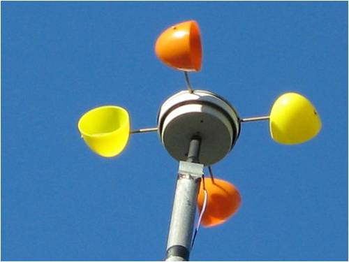

Heres a shot of my last one i built with easter egg moulds for cups.
Pete.

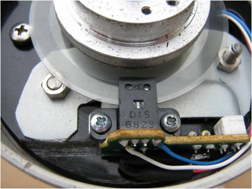

Posted: 12:20pm 11 Mar 2010
heres a photo of the internals showing the photo interupter used out of an old bubblejet printer.
You can see the amount of interrupts it has per rev. by the shaded area on the clear plastic disc being made up of interrupt lines.
Most systems with 1 or more targets (sensors) per rev. is next to useless in low wind speeds and as most bicycle computers only have 1 target per rev. I question what sort of reading they give in light winds.
Pete
Posted: 02:17pm 11 Mar 2010
Pete, looking at your anemometer cups I wonder if they survive the magpie landing on them test .
Also, why 4 cups and no three? Just about every anemometer I've seen has 3 rotating cups.
The anemometer that has been spinning on my roof for about 25 years uses cut down plastic towball covers. The black plastic survived the elements very well so far.
Water ingress is the greatest enemy of these things and it took me a few go's to figure it out . The secret was to have the anemometer hanging down and the windvane on top.
Windvane is strong enough to hold a magpie and keep it off the anemometer cups below.
Upside down mounting means no water can get into the works through the shaft. There is no seal at the shaft to minimise friction.

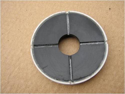

Posted: 01:12am 12 Mar 2010
Tinker,
Now you have seen a 4 cup aneometer.
Why 4 cups....Well i was lazy and routered a plastic disc out on the cnc router with a groove to locate the spokes in and rather then do the math for X&Y coords for 3 spokes i just went +&- coords on both X&Y and used 4 spokes.
The thing has never stopped spinning more than a few seconds, even when there is no breeze to be noticed.
As for the cups ...the $2.00 shop had a bag of 8 egg moulds out for $2.50 so i dont care if the break but doubt that they will as its a sturdy plastic.
I still have a spare set as well as the other half that is useable as well.
If i have a magpie problem then there will be a cloud of feathers and .....no more problem.
I do intend on putting a bit of stainless mig wire through the cups so they are not bird friendly.
William.

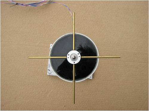

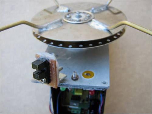

An earlier one i built used holes drilled into the HDD platter and a photo interupter, this gave me 33 holes per rev and i thought this was minimal for a decent reading as i had done one that had 6 targets and thought it was useless in less than a good wind.
The photo sensor needs to be turned around and adjusted.
I will get some more details together about what is needed for you to do a wind logger project.
Pete.

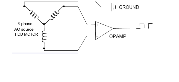

Posted: 10:52am 13 Mar 2010
As there was a HDD motor on the bench from testing the HDD generator someone else asked about, i had a play at reading a pulse from the 3 phase motor.
With the use of a opamp i get a 4 pulse per rev square wave out.
There is a little drag caused by the magnet in the motor but this is marginal and think the HDD motor could be used as a pulse generator for an aneometer without modification.
This makes the project rather easy with limited construction and circuitry.
Any thoughts on what im missing here.
Pete.
