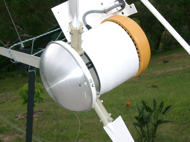

Hi guys, well,from my experience looking out the back yard at my 11 footer, i'd go for a 13 footer that maybe you could cut down a bit if you want.

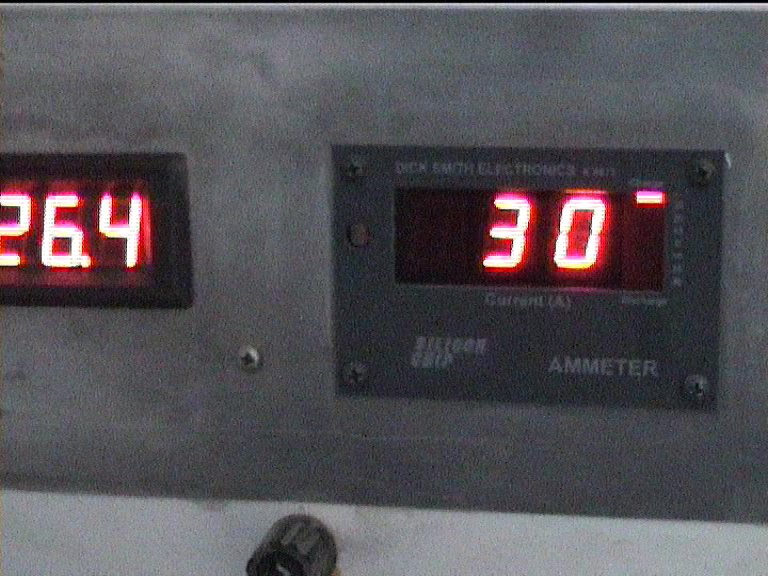

mine is looking good,but in light winds it just gets up to that magic V point of 28-30 v and then hasen't got the grunt to keep rising -if you know what I mean.
I'd also go for something around 10 inches at the root tapering to ,say, 3.5 inches at the tip.
For the F&P ,I'm now fairly sure that 2:1 belt drive is a goer- any more and it will not start in less than moderate winds-oh, and by the way ,I use a Neo magnet rotor.
So, this is why I suggest a 13 foot blade, to get the "turning power"
I have a spare 5 foot 6 inch copy of my blades,if you like i'd do a deal with you ,so you can copy it ,extend it, Etc.

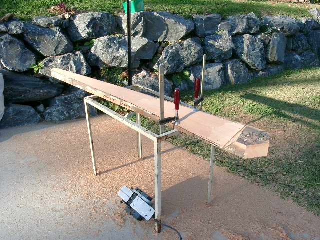

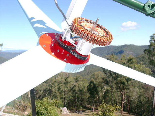

I have blades similar in length to Bush boy's
1.8 metre long 250mm at root 95mm at the tip
carved on a duplicating machine using a modified NACA4412 profile.
they provide plenty of "grunt"
wind output at about 8m/s
solar output... a bit overcast
flying

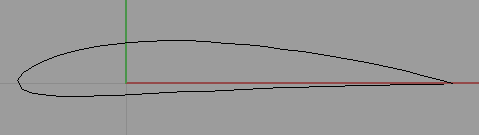

Yeah I'm the same when it comes to carving blades. I've only ever made one set, from ply wood, with no twist. I did attempt to make a set using the correct profile and twist, but it took so long to make just one blade, that I gave up. I could never get the next two blades the same as the first. Lucky for me I ended up with a set of blades carved by Dennis Latham in Adelaide, very well made. I agree blade carving is one part of windmill construction that puts a lot of people off. Some of us are gifted when it comes to shaping wood, I'm not, give me a lump of steel and a welder anyday.
The NACA4412 profile Peter suggested is a good starting point I think, its got lots of space in the middle for strength, and a nice rounded nose.
There are two "calculators" I've used in the past, and both give different results. The work by Hugh ( www.scoraigwind.com ), and the Warlock calculator. Has anyone got an opinion on which would be better to use.
