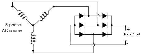

Also here is the schematic of the wiring

Ok the schematics is a bit useless to you in many ways as you do have what i think is a 3 phase motor.
Do a ohms test between each wire or the solder dots on the back of the motor and you should find 3 wires about the same ohm reading this will a low ohm reading.
This should tell you which is the 3 phase wires.
Unless it is 2 sets of coils then you will get a reading between 2 wires for 1 coil and a reading between the other 2 wires for the other coil and nothing if you have a wire from each coil.
Give it a go and let us know what you find.
Pete.Edited by Downwind 2010-03-03

Posted: 05:28am 02 Mar 2010
Yes you are correct with the multimeter
Is a process of elimination.
If it has 2 coils then the 4 wire schematic is what you will need to use.
If it is a 3 phase motor then you will have 3 wires and forget about the other wire.
Each of the 3 phase wires will go to a pair of diodes and in the case of using the bridge rectifiers you will connect a single phase wire to 1 AC terminal on the bridge and the 2nd phase wire to the other ac terminal and the 3rd phase wire to a ac terminal on the 2nd bridge.
1/2 of the second bridge will be unused.
Then connect the 2 (+) of both bridges together and the 2 (-) of both bridges together. Now you should have DC output from your bridges (+) and (-)
Connect your multimeter to the DC terminals and spin the motor you should get a reading.
The higher the speed the greater the volts.
If you short the DC wires together you should feel some greater resistance it turning the motor (you wont hurt it).....The greater the load across the DC output the greater the resistance to turn the motor.
Hope it helps.
Let us know how you get on.
Pete.

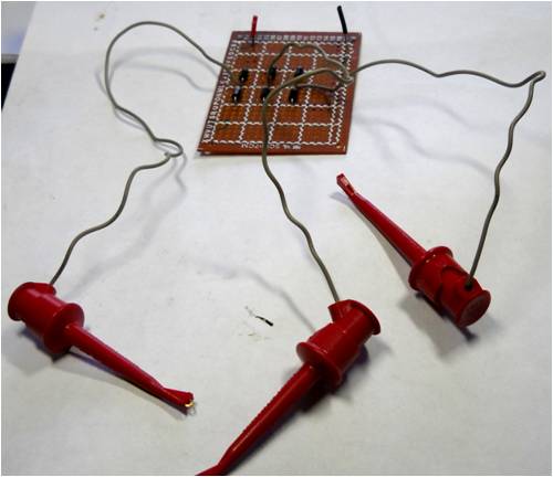

Posted: 09:14pm 02 Mar 2010
Here is a photo of a simple test board I put together for testing some of these little motors. Just hook your volt meter to the + an - select your wires and give it a spin the voltage you get for output will determine what battery size it may charge.
